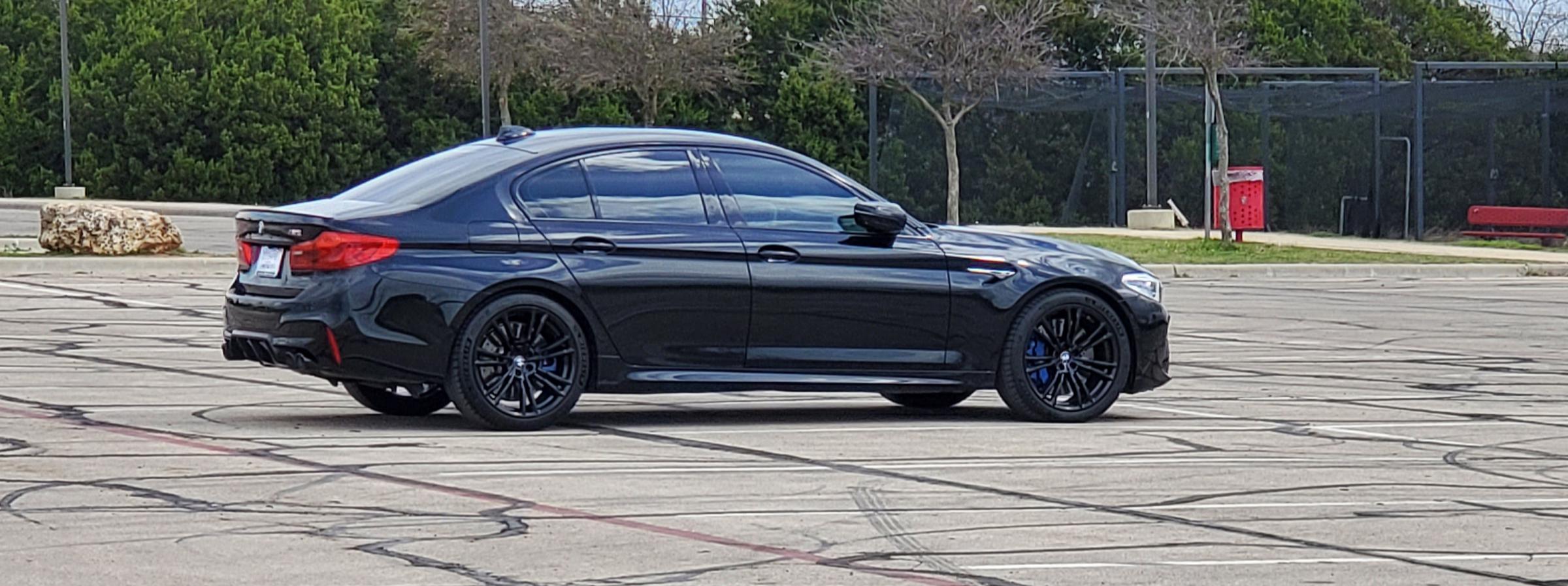

I just finished up some correction on my new to me car. Adams polishes color matches the polishing liquids with their pad color although I use meguiars 105/205 compound/polish. It takes quite a bit of compounding on BMW's clear with basic equipment depending on the severity. I corrected my wife's 330i after purchase and it took forever.

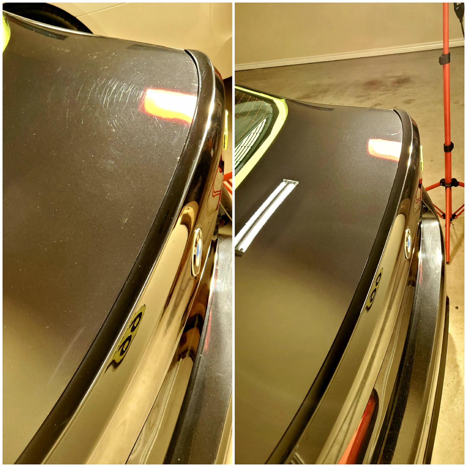

Alright I knocked it out this morning. Very pleased with the results!
The Adam’s blue microfiber cutting pad and compound followed by the Adam’s white foam polishing pad and polish worked well. I initially tried just the white foam polishing pad and polish (“least aggressive” method, no luck) and then the Adam’s one-step pad with 3D One hybrid polish (“medium aggressive” method, also no luck).
In my case the area had been Xpel coated a year-ago and I guess they were scratches/swirls I introduced into the coating. I followed up the correction with an IPA wipe down and some Adam’s ceramic coating which is curing now. Everything seems to be in good shape as far as I can tell, will let people know if I discover any issues.
Only area I did was top of trunk lid where the imperfections had been bugging me. Attached is an after photo; I forgot to take before. You probably wouldn’t be able to spot anything anyway from this photo except you can see how amazing the gloss looks.

Looks great! If it looks good in direct sunlight you've done a good job.

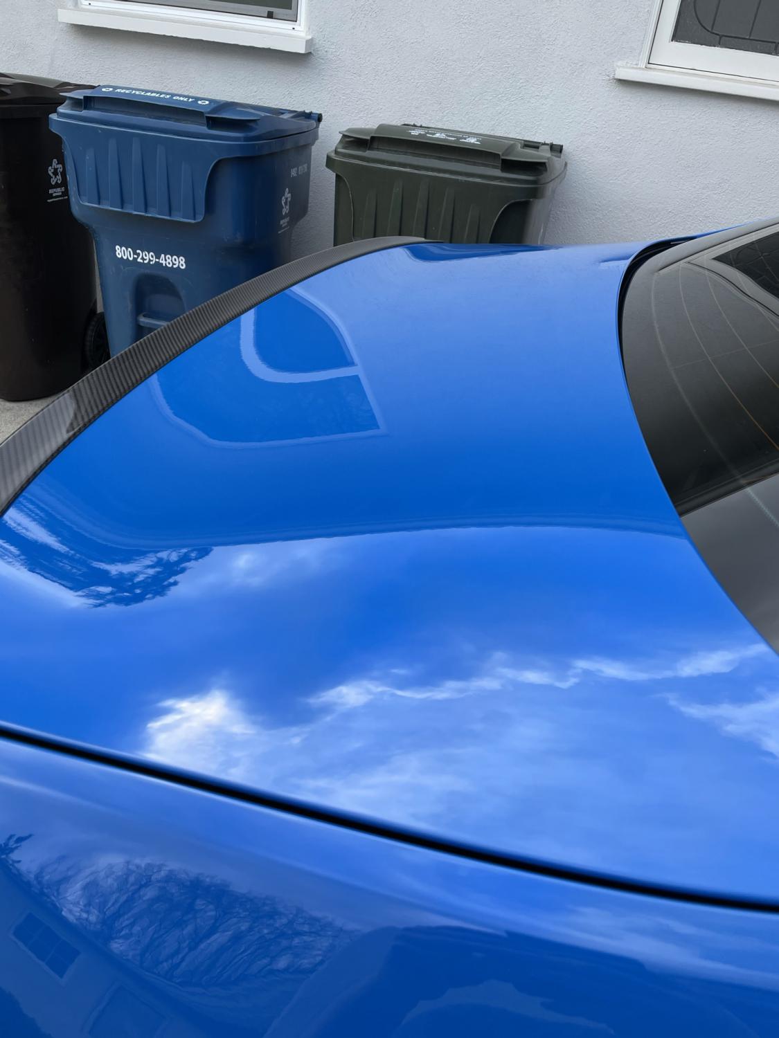

This is where I’m at. I had the pro carbon spoiler installed at the dealer, and they have butchered my trunk lid, right up to the spoiler. Pretty sure there is at least one scratch through the clear back there.

I like your enthusiasm because I’m right there with you.
I would recommend an Adam’s kit because it’s very beginner friendly but also the machine and products are high enough quality to grow with you. Maybe Griots has same I’ve also heard that brand mentioned in a similar vein. Adam’s also has a very easy-to-follow video series and an active forum where company reps are extremely responsive if you have questions (like I had).
Pan the Organizer was mentioned earlier as a super YouTube channel for all things detailing with an infinite number of product reviews. You could spend a month going down that rabbit hole. I’ve found it’s very easy to become a product junkie and buy every new chemical you see reviewed which frankly isn’t too big a deal because most of the stuff is cheap. Realistically the chemicals are very similar across brands for sealants and ceramics so unless you’re extremely discerning I very much doubt you can go wrong.
My general observation is that years ago this was a much more specialized skill where detailers were mainly using rotary buffers that generate more heat and can damage the paint easily if you don’t know what you’re doing. Now the dual action machines and consumer-grade systems are very safe and very effective for our “guy in his garage” purposes so don’t stress too much. If you just pick a good brand and start with their system you’ll find the process easy and I’m sure will be pleased with the results. Worked for me.
Adam’s kit: https://adamspolishes.com/collection...-polishing-kit
Adam’s polishing video series: https://youtube.com/playlist?list=PL...-96Shcyb3VyUDy
Pan Polishing for beginners:
Pan “best of 2020” products video:
