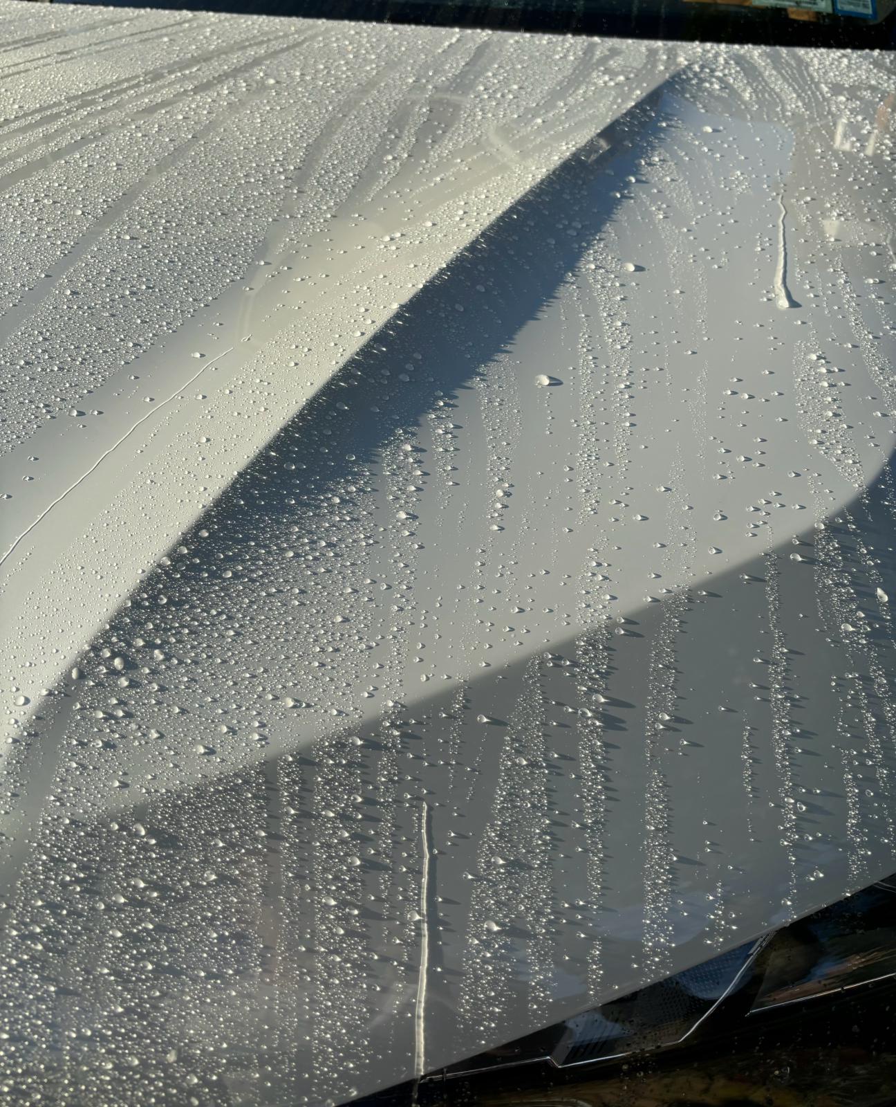

OP, if you have some time, post some pics to see how it looks now that it has been a few weeks. Pic you posted looks great, BTW

Thanks bud! I’ve not gone overboard with washing and thus far I can note the following pros and cons-
Pros
Very good hydrophobic properties
Glossy
Easy dirt removal
Less need for contact wash
Leaf blower for drying with stubby nose attachment is fantastic!
Cons
Not the slickness I was hoping for. However quick hit with ceramic detailer does wonders! And lasts
Some very recent pics including one to show water beading.
For a DIY ceramic option with outdoor application - I’m very pleased

Still looking great! Thx for the update

Looks great!
