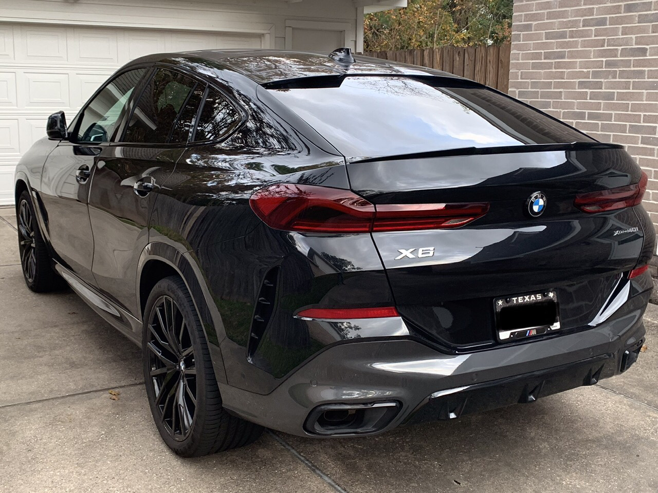

Thanks, I appreciate it.
I believe I need to buy the hydroshot and a bendable brush to help clean my wheels efficiently.
I live in a house and have easy access to water/hose on my driveway to the right of the car there
