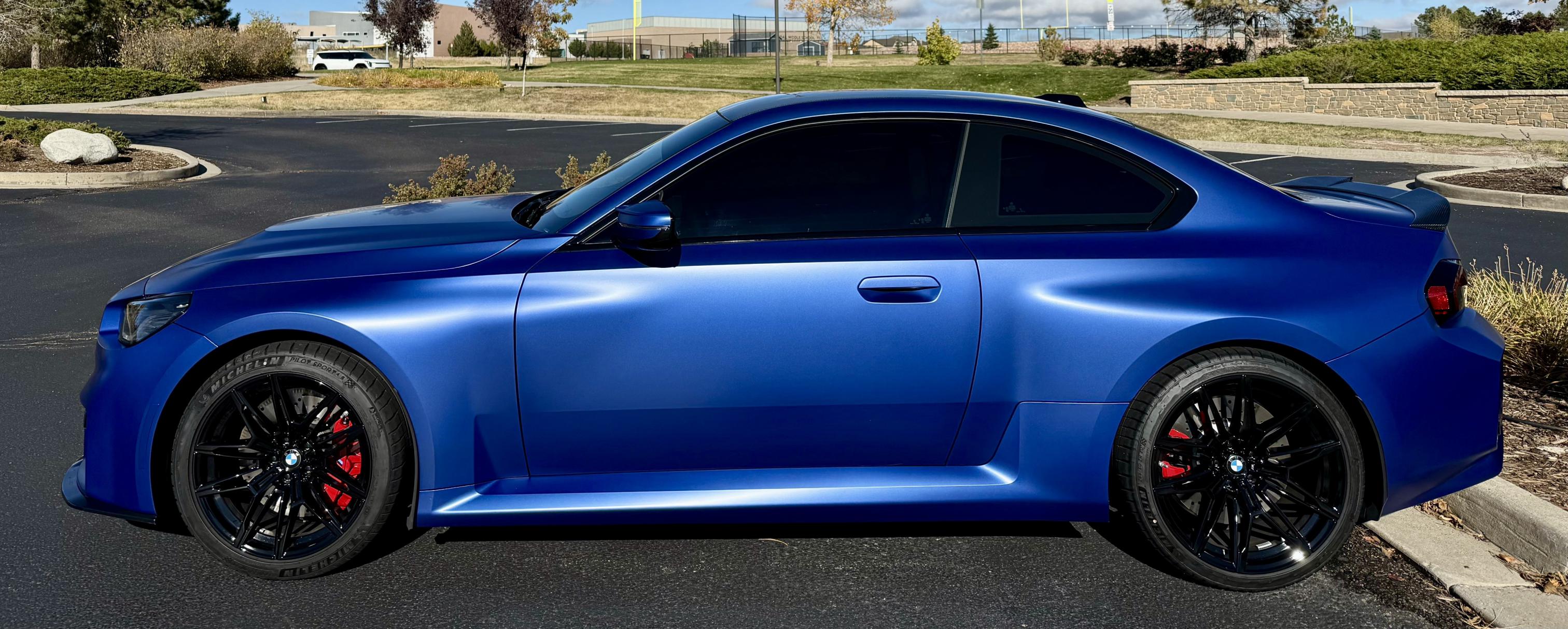

Blue Frozen Paint
Your paint looks amazing great choice . I have Frozen black paint with PPF on the front hood and front end .

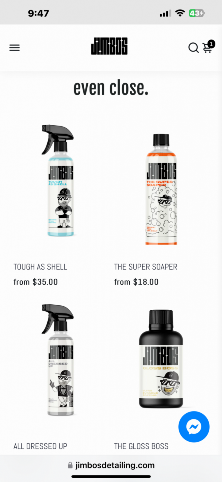

I tried Doctor Beasley’s … BMW products many more to me I pushed them all aside to keep it simple and the original paint color and finish.
1. I use Jimbos super soaper soap for foaming .
The whole treat the PPf the same
2. I use vinegar and water for water spots 40% Vineger in the mix . Less toxic and harmful and works like a champ . ( I used it all )
3. RYOBI hand held blower to dry it off
4. Once the water is almost gone I use Jimbo’s hard as shell spray ceramic . Why because long term ceramic scared me if wrong and stuides showed a spray is less intrusive to the Matt finish and there right . I love the hard as shell I use it on the rims also .
5. Wash the windows with Adam’s window cleaner micro fiber then Adam’s green glass towel by far the best application for my bmw windows I tried maybe 8 different window brands .
6. I ceramic spray every other wash
7. Use Jimbo’s formal dress on the tires
I feel I have my frozen paint under control for now but like my system

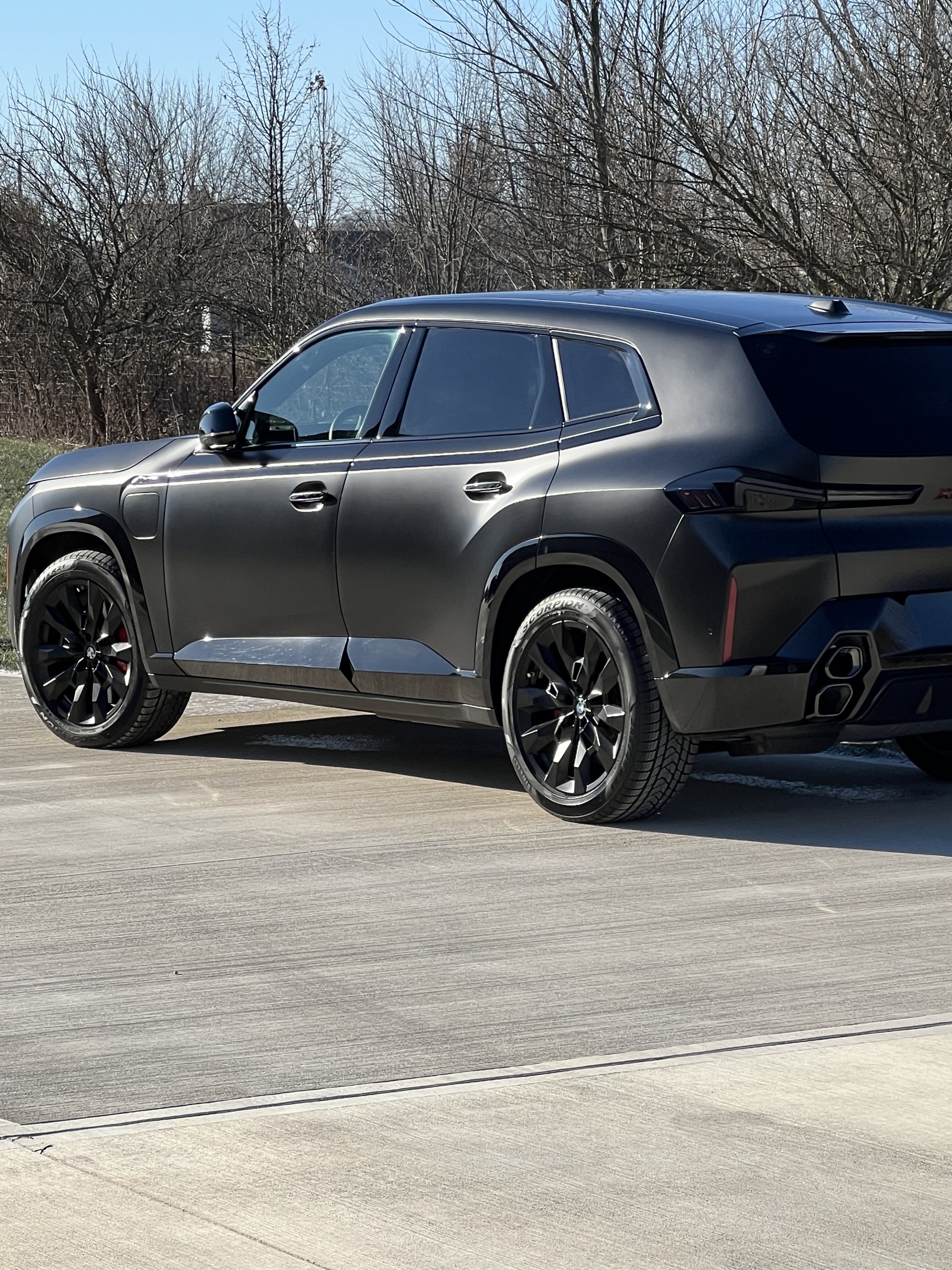

Listen the PPF vs straight frozen paint is a tough call either choice is a 1000 % correct .
Learning to maintain and protect the frozen paint without altering the finish is hard and challenging . It was for me I had no idea to be fair . And only choosing PPF for my hood and front end and not the rest of the rest of car may come back to haunt me as I am sure there is a drunken biker or piece of metal planning to hit my frozen paint as I type … but I do know this of 5 months of intense efforts and learning .. and backing out of a apt to PPF the whole car truly . It’s not easy no choice is wrong as long as your trying.
I learned that I can maintain this car pending bad things hurting to my car and at that point I will have to PPF . Until then I enjoy the many shades of the paint in various lights … my was PPF not cheap and is not exactly the same as the frozen paint on the rest of the car and that’s ok .
For me
1. I contactless wash as much as possible I read most marks in black paint are caused by the owners I froze in my tracks.
2. I do not use bmw products no dr b s I am sorry nice people or anything chemicals I can’t do it they seemed to only make issues worse to me . Nothing crazy if I water marks now I use Vinegar 40 % and water sprayed on a micro fiber does the best cleaning hands down other chemicals smear around especially on my PPF … I spent time chasing chemicals all over my PPf no more … V and water on a towel best results
3. Jimbo’s super soaker soap last 8 washes never a contact wash needed true I love that . I tried foam with other soaps then use jimbos and always saw more dirt on the floor in the foam using jimbos even after using other soap before true story .
4. Protection Jimbos hard as shell spray … easy to apply his spray ceramic to the car and towel when drying … no shine just the natural look and protection I am not changing. Long term ceramic scared me to many tests showed it alters finish not worth the chance , long term people are human mistakes are human I am ok short term ceramic spray .it works
5. Plastic trim on the xm the piano finish… it felt like if I looked at that trim wrong I got swirl marks in that trim very much worried me very touchy trim … I used Jimbo’s hard as shell on the plastic black trim swirl marks gone and have never came back so thankful .
I love the pictures of the Matt finish and everyone’s passion it’s not easy to protect the frozen finish BMW never sat me down and said do this and to be fair I didn’t sit them down and say tell me what to do . But I learned from this site … Jimbo’s detailing kind enough to help me .. and trial and error . Good luck to all very much
