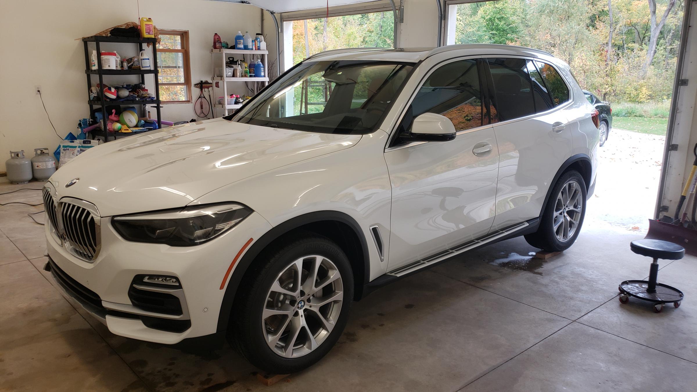

last Friday I completed the first wash, light paint polish and graphene coating. The graphene went on very well. No major differences between ceramic and this graphene. A little slower flash time. Looks great, while polishing, the gloss after polish was pretty noticeable between panels that I had just polished and a factory panel. Definitely worth the effort. In Mineral white its not as easy in photo as a dark mirror finish but looks great. I did not have enough product to get the wheels coated so I will need to do a wheels off coating after getting another small bottle. Tires have Optimum Tire (2 coats)
Looks pretty good. I will soon be taking a delivery of Mineral White. I ordered Glassparency Graphene coating. Gonna do it on my own and see how it goes. Looks pretty straight forward. Have never done any detailing before - but on a brand new car - it seems relatively easy.
