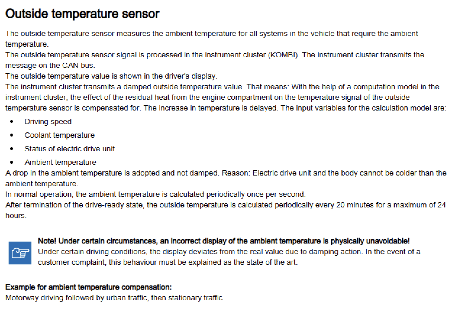

there is a lot of calculation involved in displaying the ambient temperature which can make it read differently from other sources, see info from BMW about how it works -
Name:  Screenshot 2025-02-11 at 9.06.19 AM.png
there isn't any calibration but there is an ista service procedure to test the functionality and it's also possible to code a temperature offset but most likely a few degrees off is normal.
