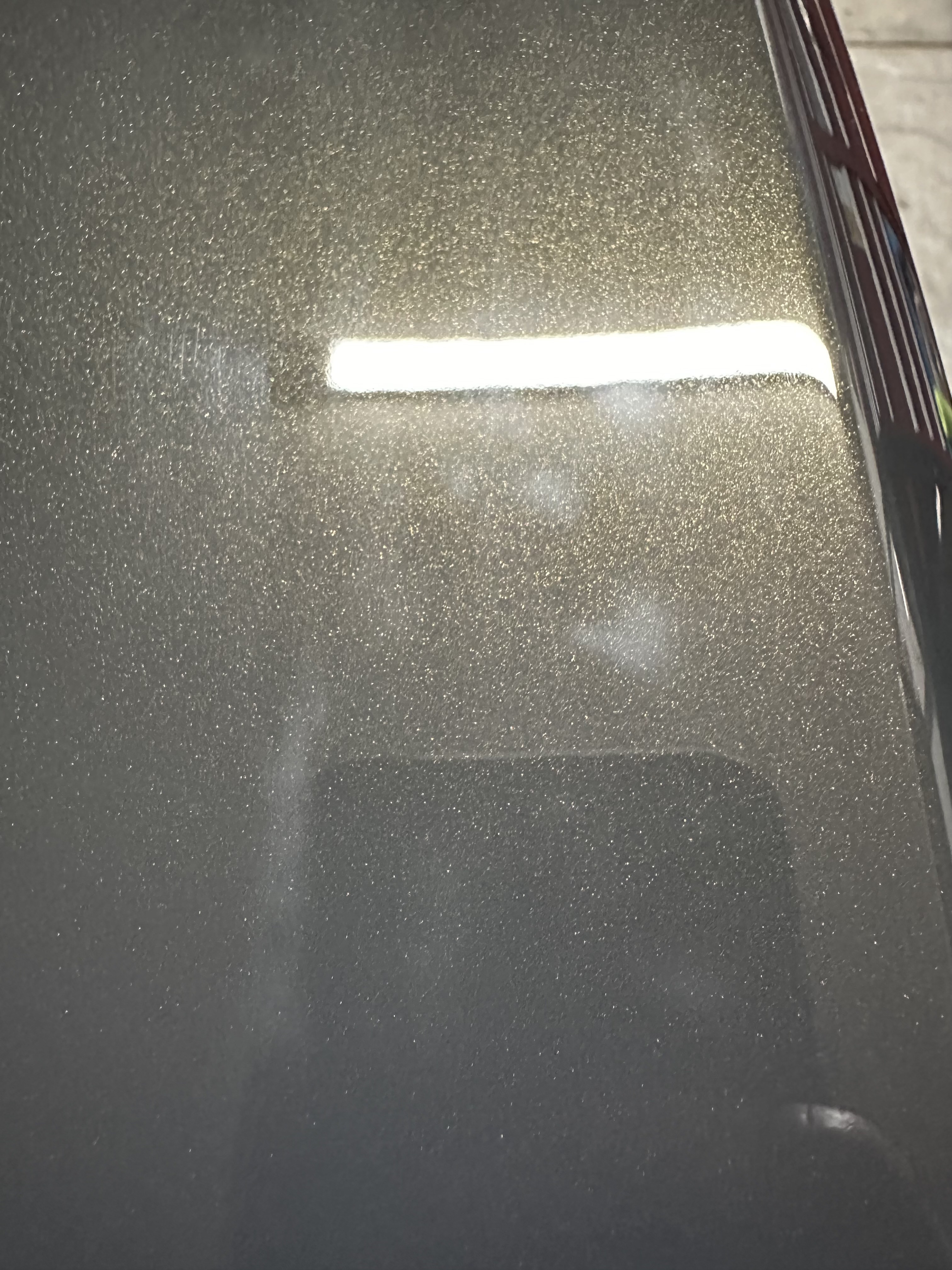

I removed my spoiler the other day and used a rubber wheel to remove the adhesive from my trunk. Now there are what seem to be light scuffing…. I’ve tried using soap, alcohol, and rinsing but it didn’t work. Is this normal and do I just need to have my trunk buffed or polished (or both) or did I damage my paint and now need to have it paint corrected ?…

Needs to be buffed out

Agreed. I see paint under it so you don't seem to have gone all the way through it.
Look up polishing compound and scratch remover. Watch some videos. Get a microfiber and go for it.

Might've stayed too long with the rubber wheel in a few places. One example where it really "ought just buff out". lol
To be more specific and keep it really simply, try some Meguiars ScratchX with a simple foam applicator pad and some microfiber towels to wipe it off. Apply wax/sealant to the area afterwards.

At the time I just assumed that these spots were because the adhesive was spreading… didn’t think too much of it. Agree on spending too much time using it than I should have… I was just focused on making sure the rubber wheel didn’t get hot…

A heavy compound then polishing with a DA Polisher should smoothen it out.

After the buff

Looks good!
Final step, put some kind of protection on it now, wax, polymer, ceramic, whatever your choice is.
