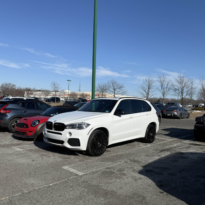

car for reference
car for reference

With that said, H&R will get you the lowest drop on this platform, but you likely won't be happy with the compromised ride quality that will result. H&R springs are not real popular on the F15 for this reason, that includes the VTF adjustable version as well. Eibach and Dinan springs will provide a minimal drop without compromising ride quality.
If you really want it low, the proper route is coilovers, either KW or BC for the F15, but you'll pay considerably more than you would for springs.
