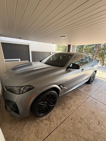

BGM80
34
26
Drives: 2025 X6M
Join Date: Feb 2022
Location: Orange County
Just got done applying Dr. Beasley's Matte Ceramic Coat. Really easy to apply. I'm not sure whether I used enough (as still a ton left in the bottle), but can always do another application and I have the AdvanceCoat as an upper. Fingers crossed for no wind but pretty concealed in the car port....
I've only got about 300 miles on the car so far, but the matte gray actually does a great job at hiding everyday dust (at least compared to my former white M3, imo).
Looking forward to easier cleanings with the ceramic coat and also just invested in a CR Spotless to worry less about the water.
Thanks everyone for the input in these threads on the products and process.
