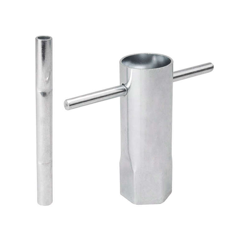

I'm trying to diy this lousy faucet that is stuck (well, tight, as if the rubber isn't moving smoothly inside the cartridge). I tried taking off the top but the ring marked in red is stuck or is one piece w the stem...so how the heck can I fit a wrench in there to loosen the nut and take out the cartridge? There must be something I'm missing. I tried to follow this YT diy video but I'm stuck (no pun intended lol).
Please help. Tia.

Socket wrench?

It appears that there is a nut surrounding the green area, so maybe the correct size socket wrench would help. It should fit inside the ring.

Many of these use a specialized tool to fit inside and turn threaded parts, or something kind of like a bearing puller that screws into the threaded hole in center of the square stem. If you know the brand, find more (or better) videos.
