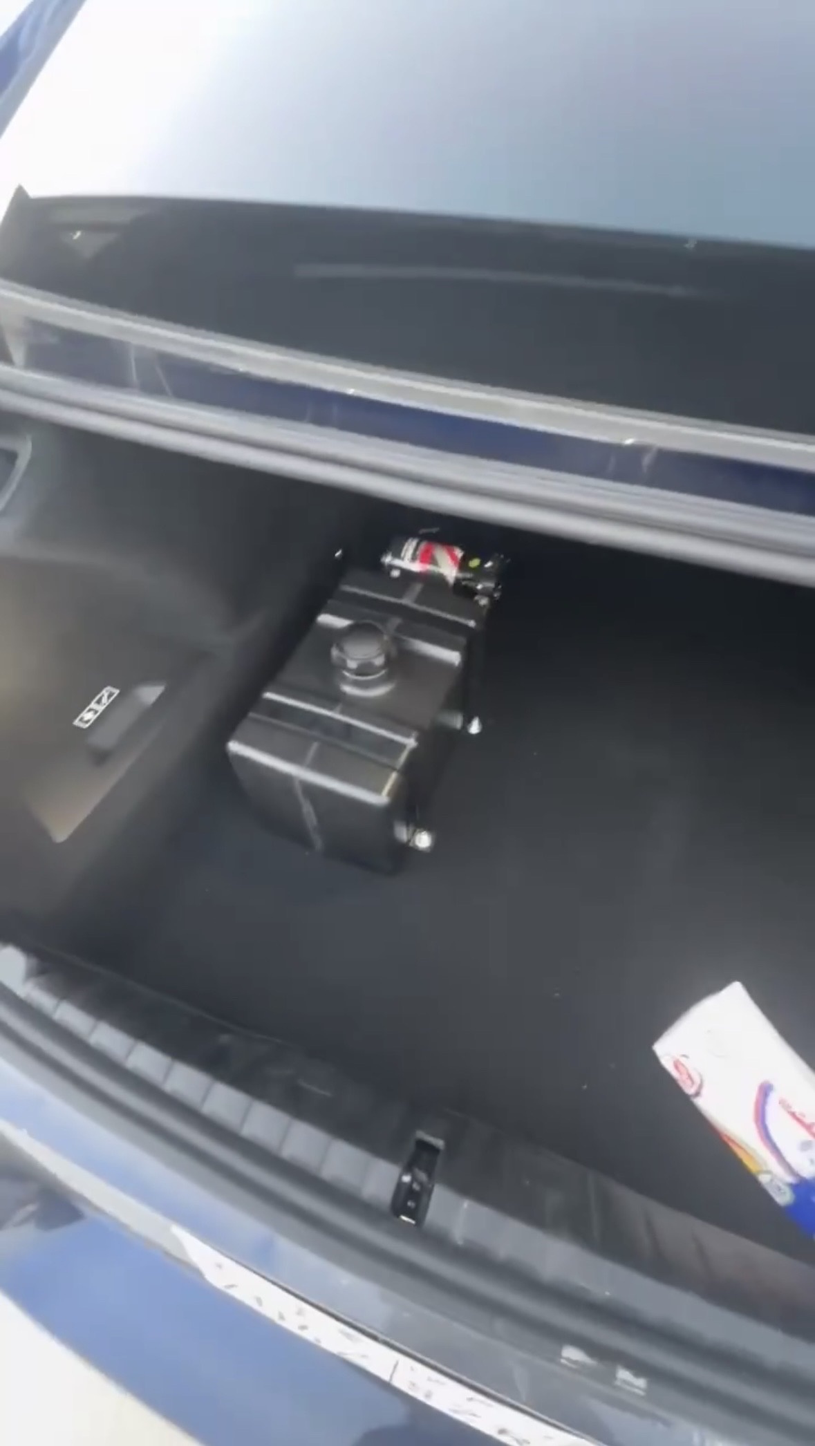

Tuned my f93 what do u guys think?
added this to my car ifykyk🤫

I have been running meth in my M5 for 4 years. What controller are you using and is it integrated into the tune or on top of the tune? I control with a JB4 and it runs on top of a BM3 Stage 2 93 tune. 2.5 gallon trunk mounted tank (but there is more space in the M5 so it sits behind the left wheel) with 2 0.8mm nozzles mounted pre throttle body in CSF intercoolers though I injected pre IC for a couple of years.

i use snow performance meth kit and its on top of the tune cus i can turn it off and on whenever i want other than it runs on a stage 2+ tune on e85 and 95 pump gas mix

Where are you injecting?

I’m running Snow Performance dual stage one nozzle in the charge pipe before the throttle body (pre TB), and the second one post-throttle into the intake manifold plenum. I’m not on direct port yet. The system is boost referenced and progressive, and I run it on top of my E85 + 95 octane Stage 2+ tune.
