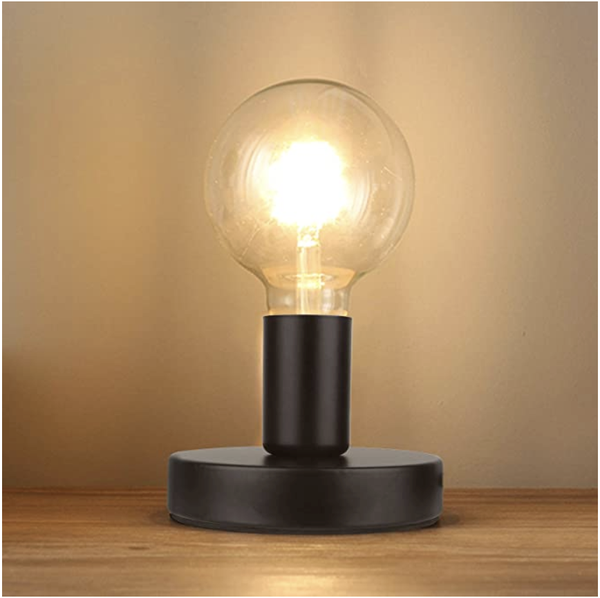

You could do what I do with my water feed in the garage - park a lamp with a 60+ watt bulb right next to it to keep temps up. We only turn it on when things get real cold. I know it is furiously low tech, but for the short term it may help.
I've read that elsewhere. I have just the device for it, too.

Here's my setup for now. 60W lightbulb and a cam to monitor it. I also stuck a second thermometer up there to compare against the one I already had there. The new thermometer is sitting atop the switches, so should reflect the temp right there at the switches.

I tried the light bulb bit, but there is no enclosure around the switches, so the light bulb wasn't really having any effect. But I reduced the resolution of the cams and moved some of them from the main PoE switch to a secondary one to lessen the power usage on the main switch. The cams are much more stable now.

Lightbulb trick is/was commonly used for well pumps and similar to prevent freezing - but requires an incandescent 100w (or higher) bulb to put off enough heat. You also could look at the pipe-wrap heat tape (also electric) - probably more reliable than a bulb and won’t attract moths. The heat of either solution could attract snakes or rodents if they are in the vicinity. Maybe a low temp switch to activate, or a wall switch so you don’t have to go up in the attic to switch on/off.
