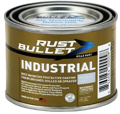

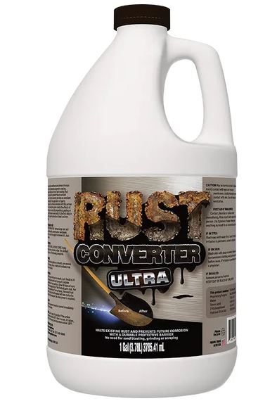

POR15, Rust Bullet, Rust Converter Ultra - Anyone used these rust treatments?
Wondering if anyone used these products to coat rusted areas and how they hold up over time?
They all hold pretty good reviews, however i was hoping to get some of our e90post veterans' opinions.

Ended up getting a bottle of Phosporic Acid 85% as it is main active ingredient in all of rust converting products that actualy work as per reviews.
Going to dilute that to about 45-50% Phosphoric acid and apply to rust to stop it and conver it to iron oxde. Then i will follow it with a rust coating such as POR15 or Rust bullet.

I've used Por 15 and RB. I prefer P15, it's thicker. Both work well. Both have similar quality prep products. I've used P15 on just about every brake rotor I've had / installed over the last 15 years, barrel and edges. Looks great. I've also done a couple trailers and other projects with both products. Anything regularly exposed to sunlight will need a top coat. Prep is key. Whatever it gets on it stays on. That's about it, P15 for the win.
