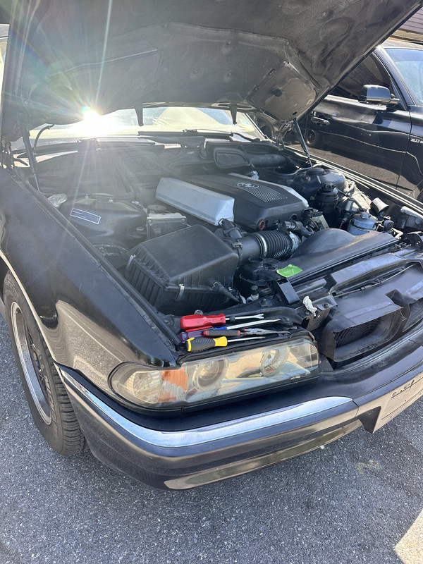

Last week I purchased my first BMW a decently maintained 1998 E38 740i in Schwarz Black over Tan Interior.
Only has just over 160k miles on it.
According to the previous owner who was an older gentleman who likes vintage BMWs, Interior is in a pretty good condition despite some minor interior issues. It even has the First Aid in the back seat still intact.
This was what he did during his ownership:
Maintenance
- Changed Power Steering Fluid
- Put on New Michelin Tires (Tread life is very good)
- Replaced the O2 sensors (Apparently not OEM)
- New Battery (From Die Hard)
- Catalytic Converter Replaced
- Timing Chain Guides and Belts replaced 55k miles ago
- Front struts replaced 5 years into his ownership
- Rear Shocks replaced
Add-Ons/Upgrades
- Had a Viper Alarm System Installed (He had this car since 2015 as I know Viper is kinda like a mid 2000s to early 2010s thing haha)
- Pioneer Audio System with Infotainment and Subwoofer (however it looks very mid 2010s)
-Backup Camera installed with the Pioneer System
So far I like driving it and it is pretty smooth once it gets going plus its a comfortable cruiser!
However, it still has some issues that I need to address mechanically and cosmetically. They are listed as follows.
Mechanical Issues to Address/Fixes

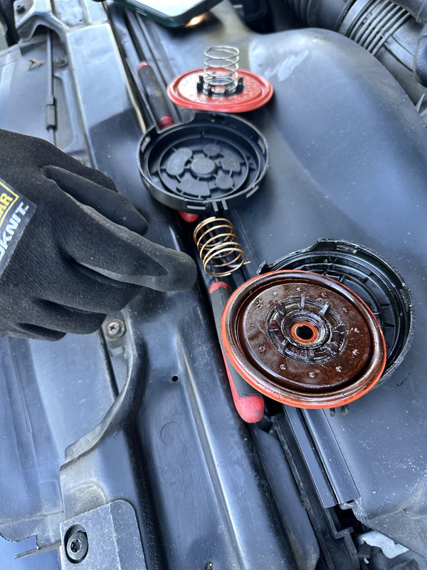

- 2 days after buying the car, it began bellowing alot of white smoke through the exhaust system on idle and start up .
(Found out this was the PCV Valve so I went ahead and replaced that which resolved this problem.)
- ABS Light is on previous owner stated that a sensor having to do with the ABS needs to be replaced.
- Check Engine Light is on ( I am going to have this diagnosed today on my Mechanic friend's scan tool. However from the past few days of driving it I have experienced some rough idling and shuddering intermittently while driving. Sometimes the car will stall from a cold start. From my research those appear to be symptoms of the Camshaft Position Sensor going bad thus the main or one of the reasons the Check Engine Light is on.)
- Air Intake Boot Hose is cracked and some outside air is able to escape in. (I have a new one ordered that should be delivered today. This might also fix issues I stated in the point above.)
So far I have replaced the PCV Valve and did a full oil and filter change on the 740i this past weekend and next up is replacing the Intake Boot Hose today.
Cosmetic Issues to Address/Fixes

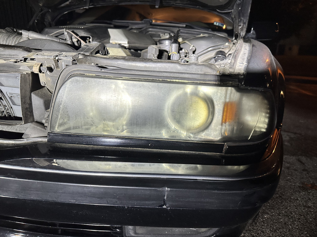

-Headlights fogged up (I went ahead and got a kit to restore the headlights and was able to restore them to a near new-condition)
- One of the bulbs in the driver side headlight is out. (I plan on either replacing the bulb or swapping in new headlights entirely)
- Left side grille insert is cracked (I plan on replacing the entire grille and chrome surround for it)
- Cupholder in center dash is completely in-operable (not sure what I will do about this yet lol)
- Upper Body of the car on the sides could us a paint buff.
- Glove compartment latch is broken (Previous owner went ahead and had the latch pulled off and had the Glovebox literally nailed shut lmao) I might replace this but it'll be one of the last things I do haha
Any suggestions or helpful advice as I embark on this journey of E38 Ownership?

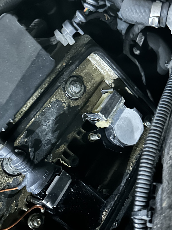

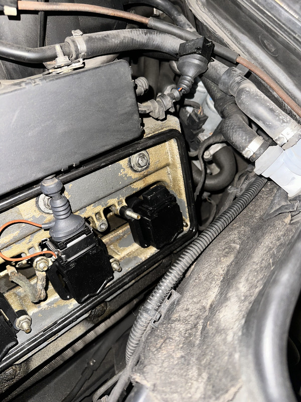

So after replacing the air intake hose, I had a weird shaking when under 2k rpm in D, R and sometimes in P at idle. Check Engine Light had came back on. Me and my buddy ran OBD Scanner and checked the codes, come to find out Cylinder 2 was misfiring and causing the other Cylinders to misfire I think.
Upon further inspection, cylinder 2 wasn't firing at all apparently, thus was causing that rough engine shake issue and also the loss of power I had experienced driving it the past few days. Seemed like the engine was in limp mode.
Changed the Spark Plug as we thought it was the spark plug at first but Cylinder 2 still wasn't firing. Swapped the ignition coil with another cylinder's coil and there lie the issue. Cylinder 2's ignition coil went bad and we went ahead and replaced the coil. Replacing the coil got Cylinder 2 up and going with no issue and power was restored to what feels like full power, V8 sounds nice aggressive again. Cleared the CEL and will monitor now, if it comes back on check for codes, investigate and repair based on codes.
Rinse and Repeat haha

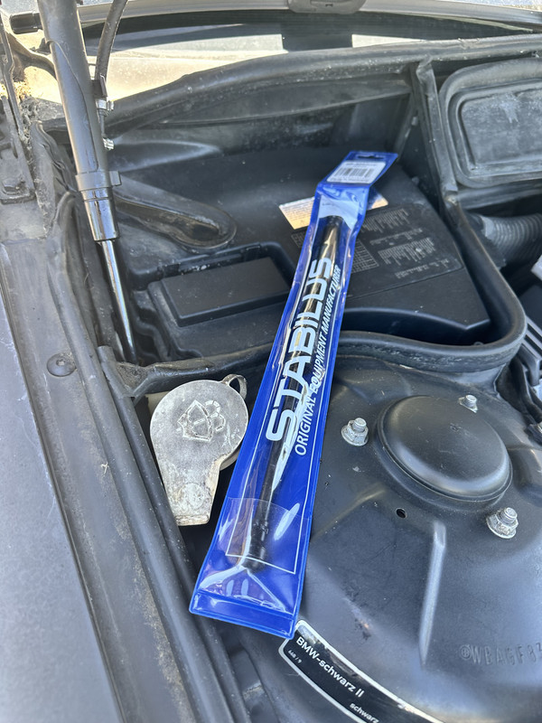

Driver Side Hydraulic Trunk Strut broke on me last week so I ordered a replacement part and got that installed within 5 minutes! Easy fix! See photo below

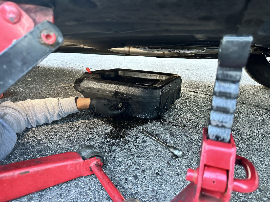

Transmission
- Something told me to get the transfluid checked and flush.. I turned out to be right the trans fluid looked quite bad, so I did the first stage of flushing the fluid with fresh fluid. (Btw does anyone know why BMW didn't put a trans fluid filler cap at the top of the engine bay? the whole pumping thing was confusing for my first time but I got it done and figured out.)
- Transmission feels much better and shifts better from what I've experienced since driving with the fluid flushed partially, the final stage of flushing the fluid will happen this spring

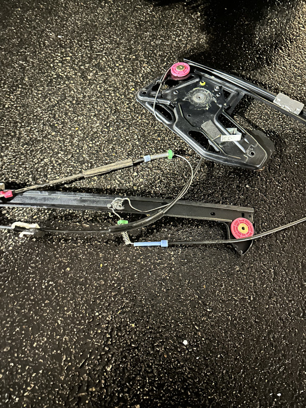

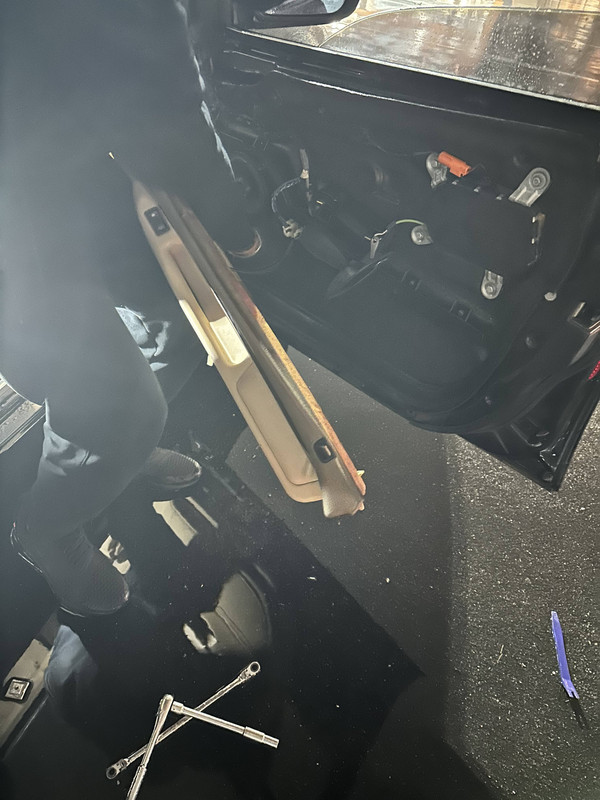

SUPRISE - Passenger Window Stuck Halfway Down!
- So I had a friend riding in the car with me one day late last year and they decided to roll the window down to get some food that was brought out to the car at this restaurant, and lucky me he rolls the window back up and it only goes halfway up and does not move any further. Quickly searched up a passenger side regulator and ordered one for $40 to replace it.
- Enlisted my trusty BMW Friend/Mechanic to help me with this one, took a good 2 hours or so but we got it done!
- If you take a look at the photos below you can see the old regulator, the motor was fine, but the cable was brittle and got mangled causing the window to be stuck in place.

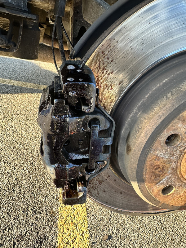

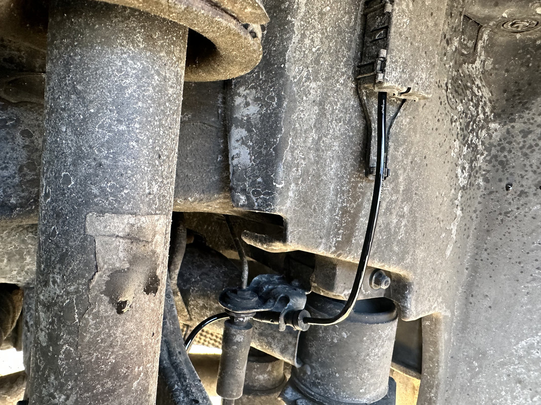

Speedometer dead! - Wheel Speed Sensors

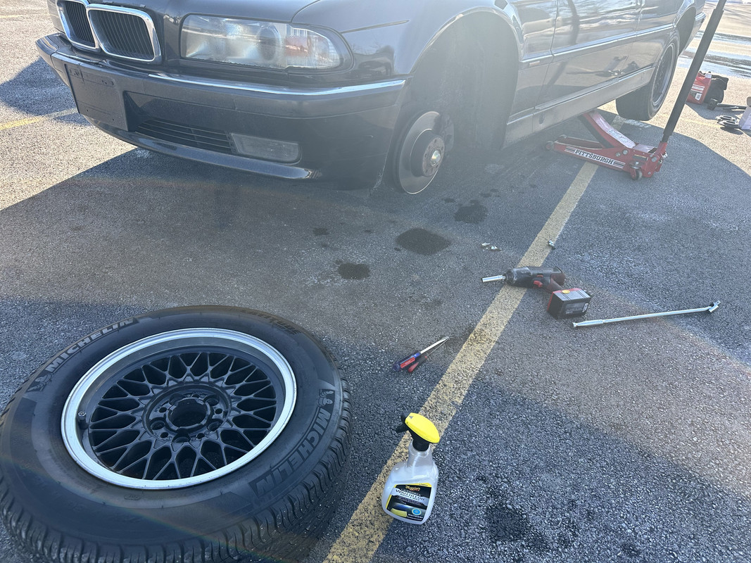

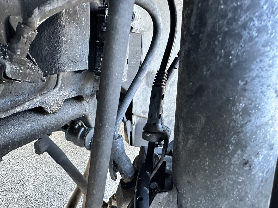

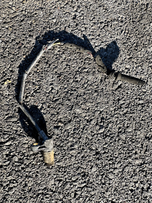

- I was meaning to get around to doing my wheel speed sensors on all 4 corners, as my ASC and ABS light was on since buying the car. But my 740 forced me to when the speedometer died on indefinitely. (which also freezes the mileage on the odo from what I found out.)
- I had the wheel speed sensors sitting around since early November, just didn't have the time to sit and do them with all the holidays and family gatherings happening on top of work and such.
- So I went ahead and swapped out the sensors today when the speedometer needle just fell yesterday evening and would not spring back to life. It was pretty easy to do myself with the help of taking the wheels off to do it it also cleared my ASC and ABS light as well
These are the factory OEM Sensors and they look DESTROYED I am surprised the wheel speed sensors worked for so long seems like they was NEVER changed
The new sensors went on just fine and all 4 were replaced

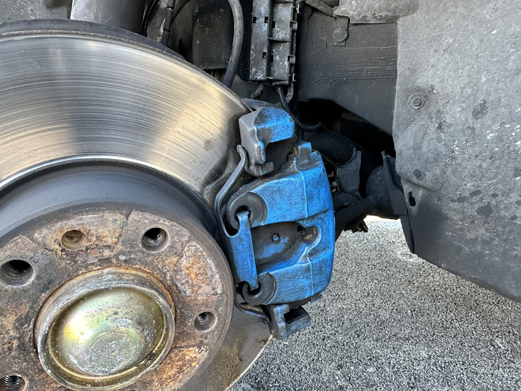

While I was at it I went ahead and did my best to clean off all the calipers they pretty much was consumed with brake dust & looked like they were never clean since leaving the showroom floor new.
I will need to have it water blasted to get the rest of the brake dust off of there, but to be honest its nearly impossible to keep them clean with the 'Style 5' wheels on the car.

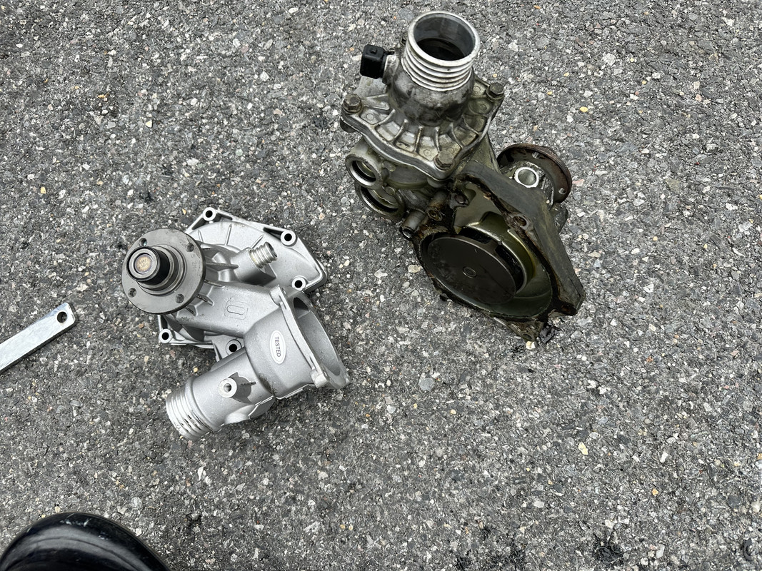

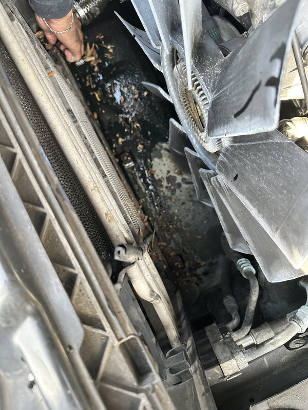

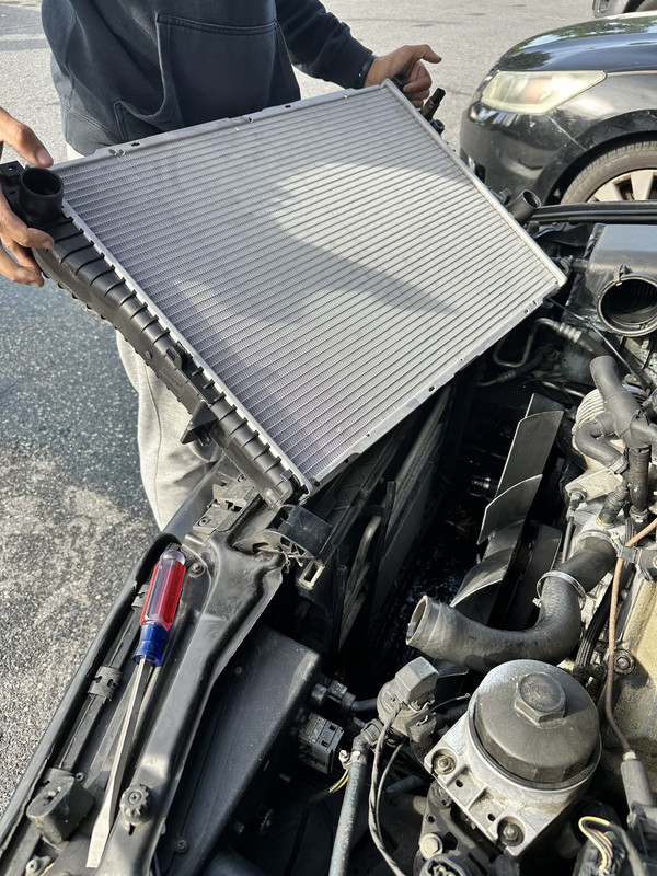

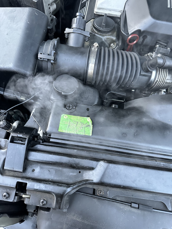

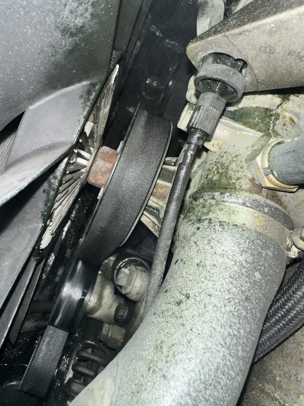

Update II - Coolant System Catastrophe
Cooling system overhaul including water pump. Congrats on the car, good luck with it.

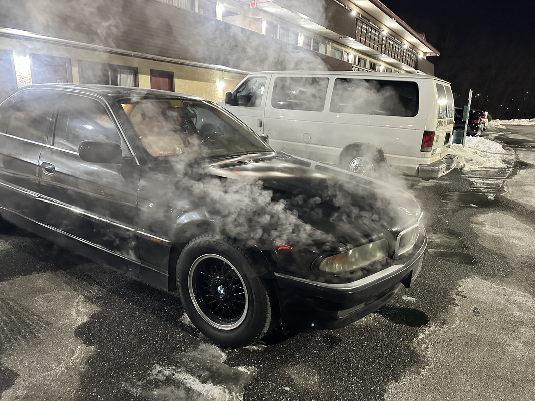

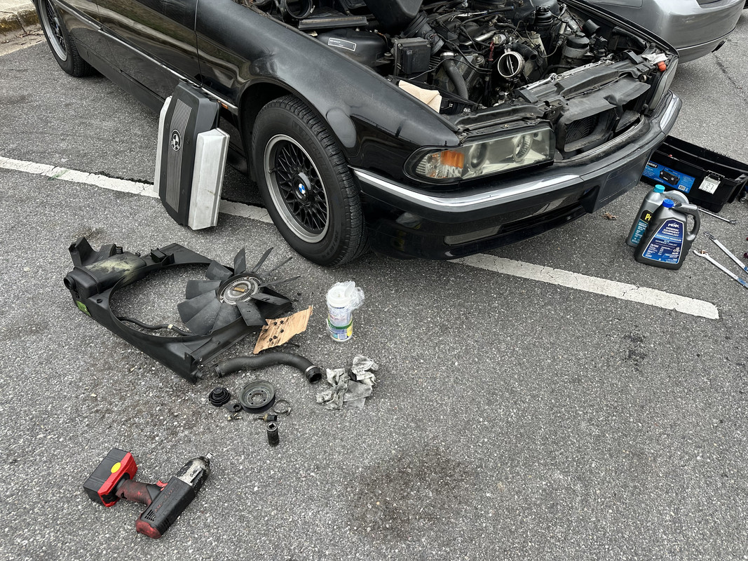

Funnily enough the water pump failed earlier this year haha

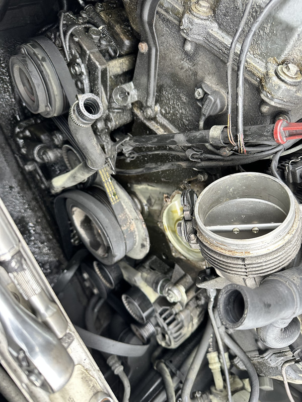

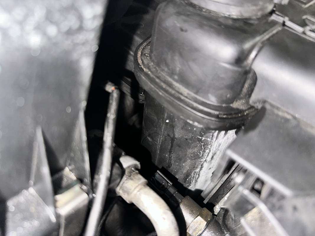

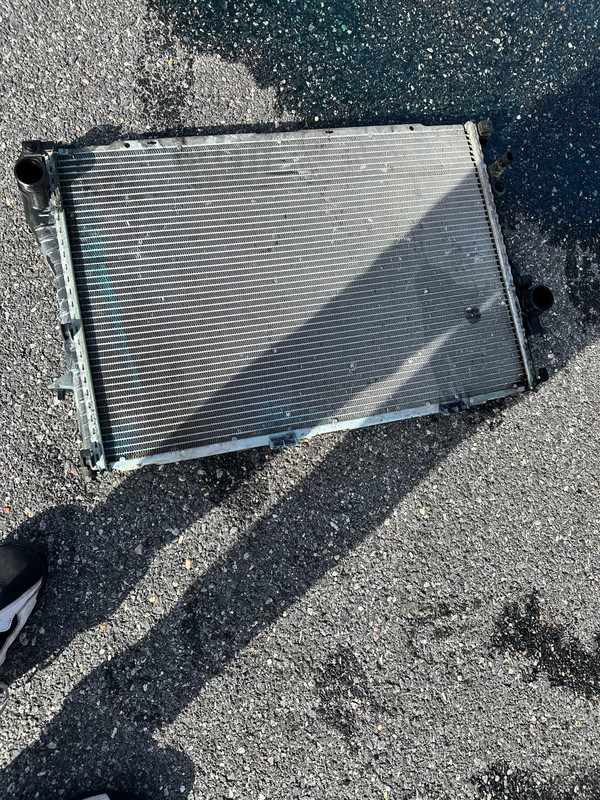

Coolant system failed on me with little warning one night in February I had to pull off in a random hotel parking lot and get towed home so that I don't overheat the engine.
Smoke bellowed from the engine bay smelled like straight coolant.

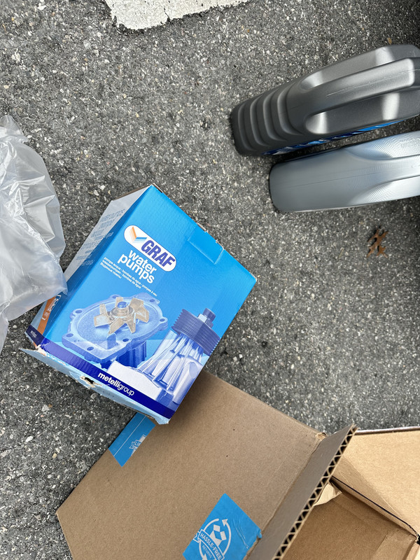

Come to find out my water pump failed and the coolant expansion tank had a bad leak on top of the expansion tank cap no longer sealing the cap effectively
So I geared up, placed my order on FCP Euro and ordered new coolant tank, cap, and water pump. Had my trusty mechanic friend come help me with this. Because as @Chihuahua said "Labor is free!" Save for a meal and $100 to my mechanic for driving out to me lol
Recently I had another cylinder misfire caused by another ignition coil that failed. Replaced that with a new coil. You guys probably will tell me to go ahead and replace all the coils so I will go ahead and replace the rest in the next month or so.
Out with the old and in with the new! The fun part about this was finding which one as I didn’t have a OBD scanner on me and NOT losing my 10mm in the engine bay lol

This past month I have learned that RockAuto pretty much has the best price overall beating out even FCP Euro.
So as of recently I pretty much overhauled my entire coolant system now.
New Radiator and Thermostat
The Radiator had a blown tank on the inside and it was causing the whole system to lose pressure and cause the coolant to get hot thus steaming out the radiator.
I also replaced my hood struts since they also failed that was the easy part lol
Next up I finally can move on to suspension refresh and brakes
Front Suspension refresh is gonna run me about ~$650 in parts alone. not bad at all.
I got a "check brake linings" message in the dash so seems like the front pads have hit the wear sensor.
I have new rotors and pads ready to install just waiting to get with my mechanic and get them installed on within the next few days.
Do I need to replace the wear sensor too? or rather is it worth replacing the wear sensor? I can get one from FCP or Rock Auto for pennies just need to order it.
M5Rick79706.50
      05-16-2025, 04:17 PM   #21
79707
Looking at the age of the car I would replace the sensor wire.
MarcoF90203.00
