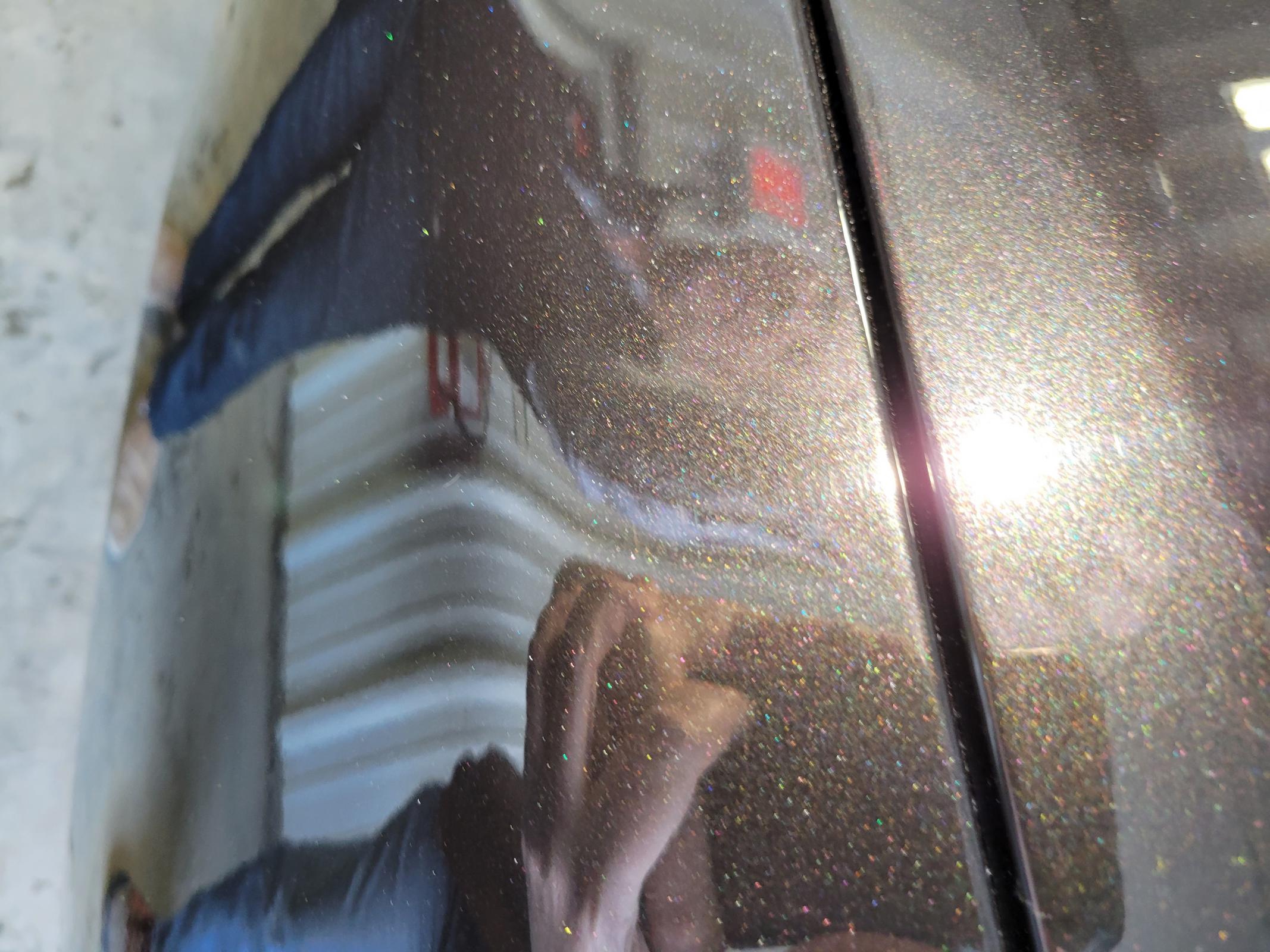

On friday I had a test polish performed at a local detail shop to see if the polish would make the two paint finishes match better. The detail guy came back to me and simply said the paint match was awful and the metallic flake was too much and too big.
I never heard back from my insurer so the car goes back to the same autobody on January 30th for them to repaint the bumper and rear quarter. At least they arranged for the dealership to give me a loaner so I have to give them credit for that.
I'll bite my tongue until I get the car back..
Rob

The autobody wanted me to verify I was happy with the repaint before putting the car together. Is it absolutely 100% perfect? No, but it is much better than before.

I learned it the hard way just today — I used a “matching paint” from Amazon (known brand) and it didn’t match at all. I finally drove to my auto body supply shop and apparently over the years, there are 13 (!!!!) variants of this color in the system. He used my VIN to mix the correct color variant and the paint matches much much better. Lesson learn — the paint code by itself is not enough to get good paint match. Don’t be lazy, go to a good store and get the right paint.
