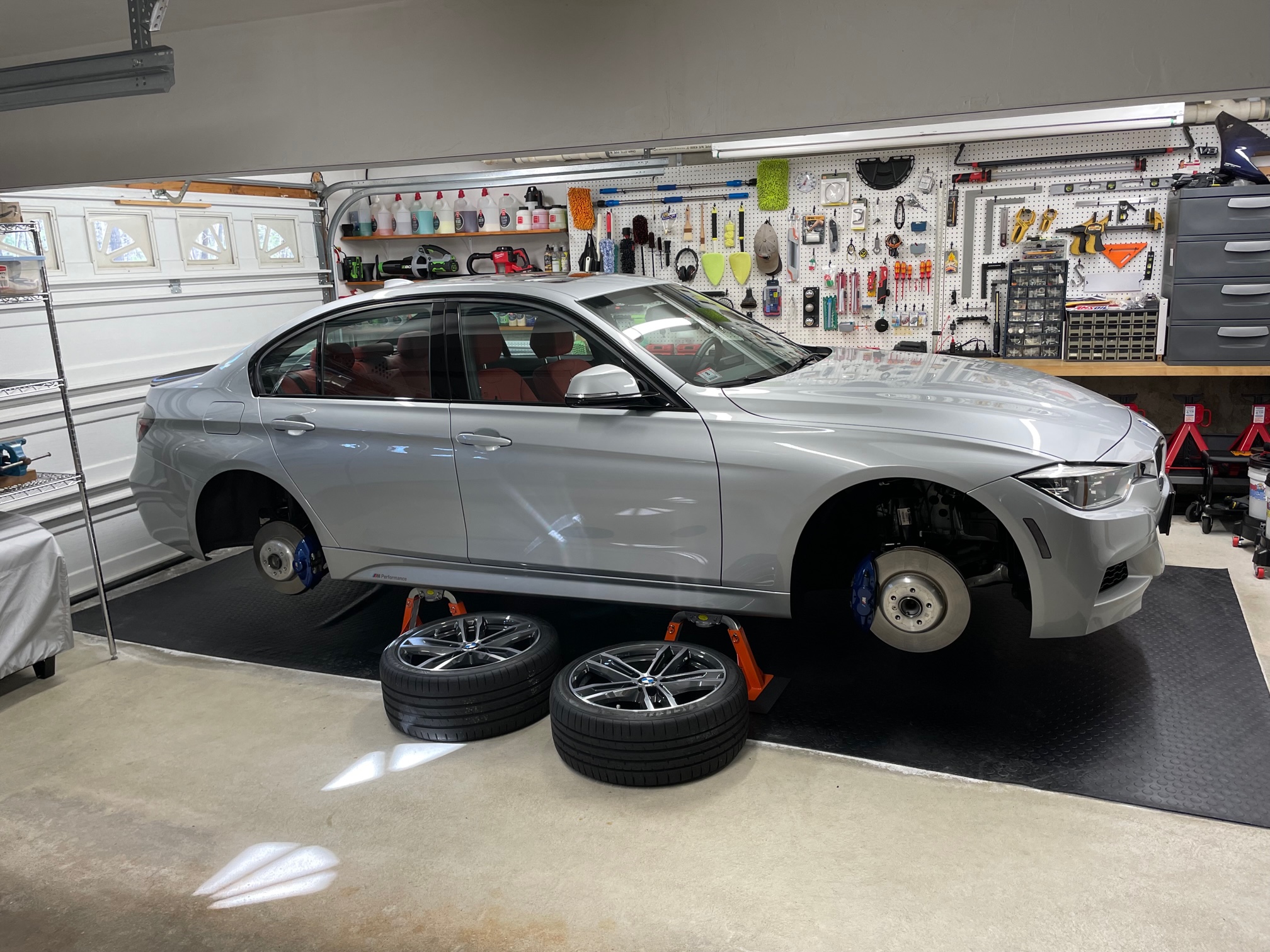

Originally Posted by disintegrator66 View Post
While a scissor jack isn't quite as stable as a jack stand, its arguably more stable than relying on a hydraulic floor jack.
In my experience it's exactly the opposite. Say, when using a scissor jack I did bother to put a wheel underneath the raised car just in case. No need with the HF floor jack which is rock solid (yet, no getting under the car, of course!). Yes, you should mind the hydraulic jack's condition, but if it works it just does. A scissor jack doesn't feel that stable and it eventually breaks (the BMW one got it's plastic bushing destroyed by the metal screw rod, luckily at the best moment possible though yes, there had been signs of weakness before that happened).
And by the way, a very nice garage you have!
You're looking to avoid a floor jack and there aren't many options. While a scissor jack isn't quite as stable as a jack stand, its arguably more stable than relying on a hydraulic floor jack. Again, not MY first choice, but an option if you don't want/can't use a floor jack/jack stand combo. I use ETA Manufacturing jack stands which need a floor jack...
These jack stands are really slick!

      05-11-2024, 04:39 PM   #39
disintegrator66
disintegrator66's Avatar
474
396
Drives: '18 340i M-Sport 6MT THP MPPSK
Join Date: Mar 2018
Location: MA
Thanks... Money well spent!

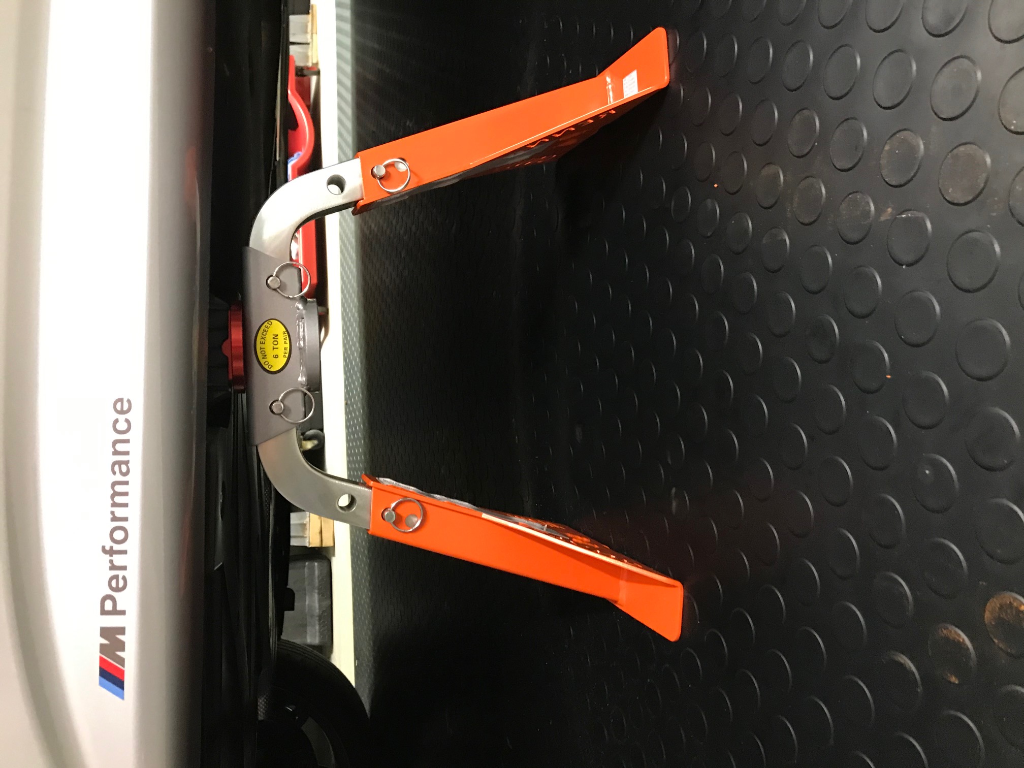

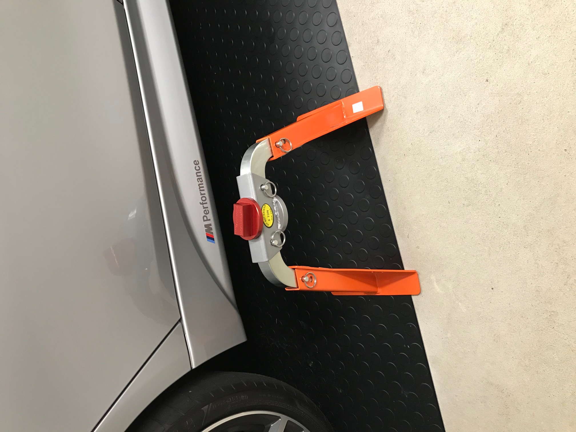

      01-24-2025, 01:01 AM   #40
partialresponse
12
89
Drives: '04 E46 ZHP 6MT, '22 G22 RWD
Join Date: Jul 2021
Location: San Francisco Bay Area
Where did you buy the red jack pad adaptor for the Rennstand?
      01-24-2025, 08:15 AM   #41
ipilcher
ipilcher's Avatar
665
1,068
Drives: 2024 M3 Compensation
Join Date: Nov 2013
Location: North Texas, USA
And where did you find a jack that fits under our cars with the Rennstands?

      01-25-2025, 01:01 AM   #44
disintegrator66
474
396
Join Date: Mar 2018
Location: MA
It’s a modified Burger Motorsports (BMS) jack pad. BMS is one of the few manufacturers that has a jack pad with the correct height so that you’re not crushing the car’s plastic receptacle. The modification is drilling and tapping a hole so that I could mount a 1/4-20 bolt and spacer to act as a positioning stud when sitting on the Rennstand. I use a low profile floor jack to lift the car.
Cheers!
