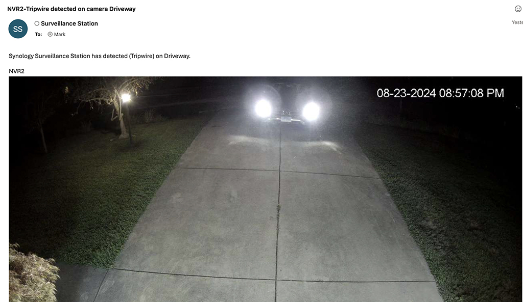

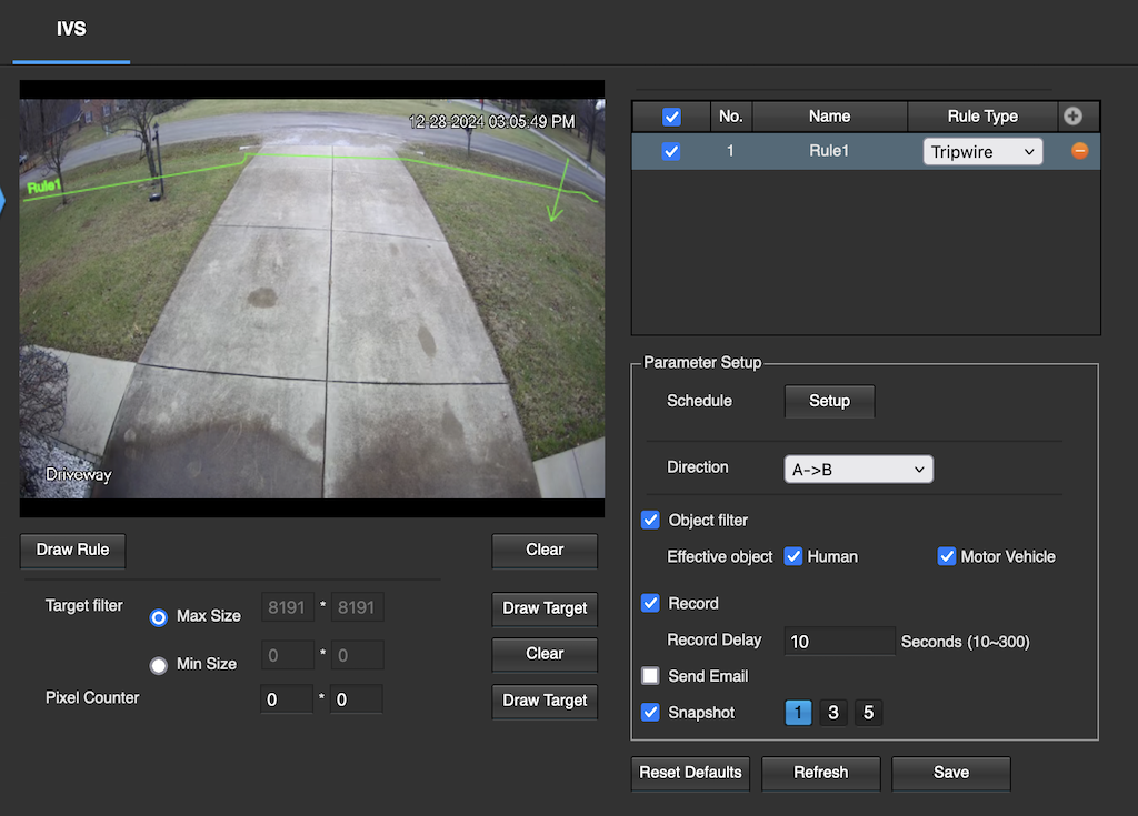

My Amcrest cams (and many others) allow you to create Tripwires. Virtual lines that trigger notifications when crossed. I have Tripwires along the entire front and sides of my yard. That way when I'm out in the yard doing yard work or whatever, I'm not getting pelted with notifications. I only get them when someone crosses the lines. I'll do the same when I finally get PoE cams covering the back yard. Here's a typical email notification I get. This is us coming home last night.

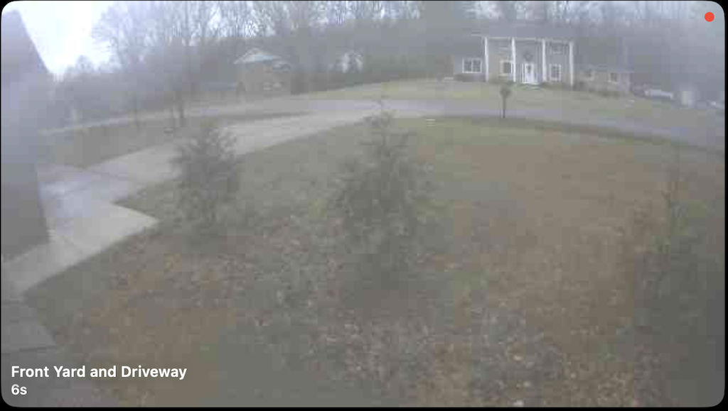

This is what I was saying about blurred images in the rain. It stopped raining hours ago and this Eufy camera is still a bit foggy. It was quite a bit worse last night when it was raining.
