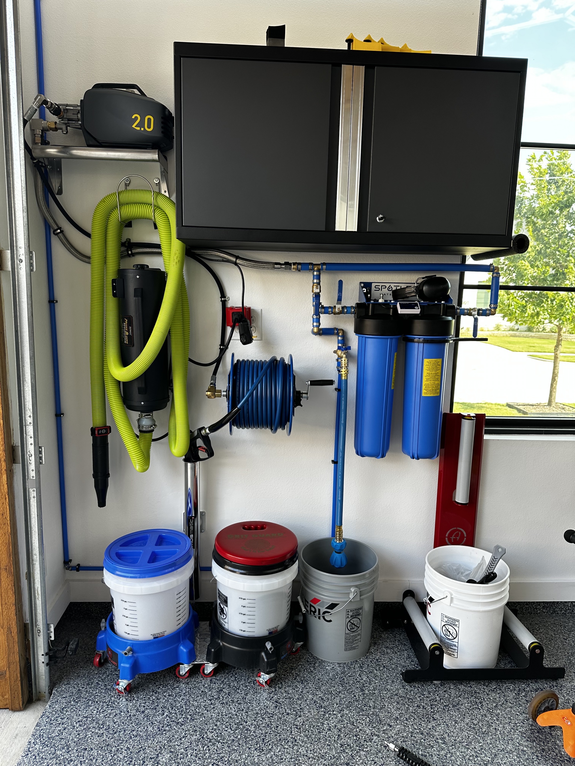

  [10.00]
Active 2.0 here. Agreed, noisy, but cheap.

That's a nice setup. Wheel wash station on the right?
