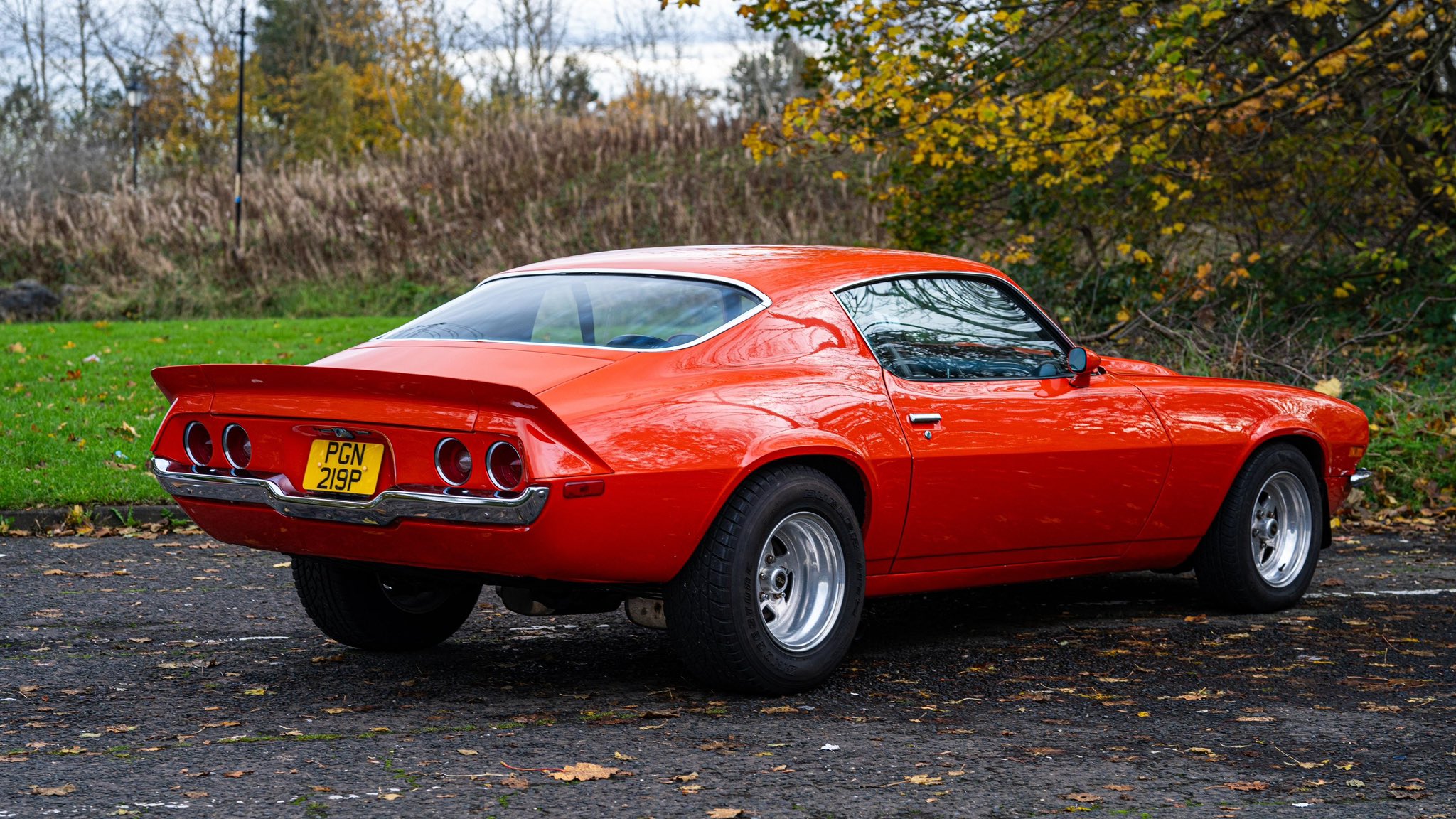

Smaller tire is not going to fill the wheel well. It's still going to have the same ride height. Also Streten mentioned the suspension is junk so if the fronts are ridding on more spring then the rears it will make it look like a 70's muscle car on rear air shocks that was all the rage when I attended high school in the early 80's.
Never understood this as a teenager.
