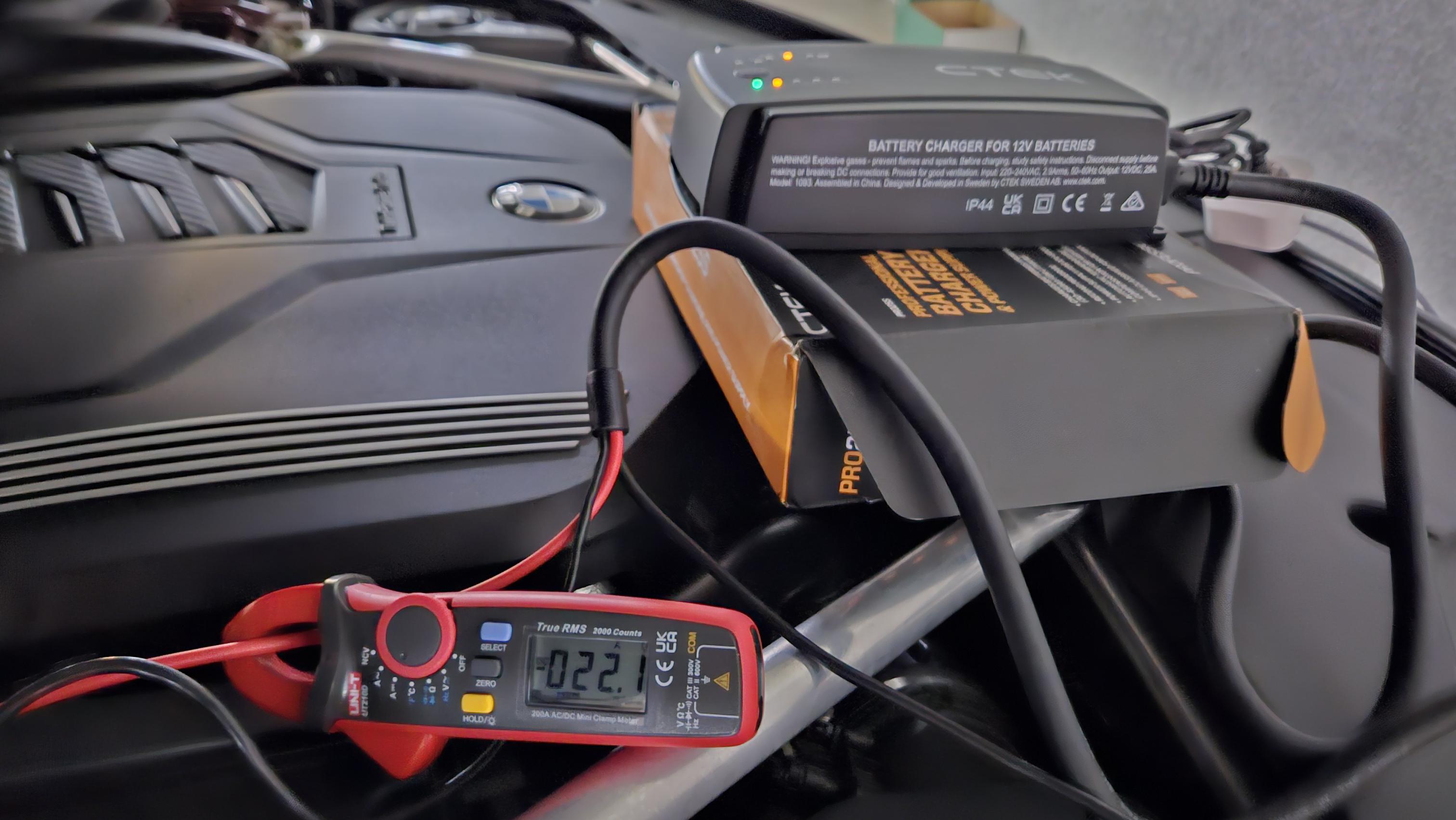

To add a data point this is my observations:
I sat in my parked G22 MHEV, engine off, for an hour (preparing several routes for a road-trip) so I though I should try my new CTEK PRO25S in order not to discharge the batteries.
The observation I did not expect was: Both the 12V battery and the 48V battery was charging!
Configuration:
* The charger (can supply 25A) was connected under hood.
* Hood open (resting on the first latch).
* Car was "ON". Was using the navigation in iDrive.
* BimmerLink connected to OBD2 to monitor charge levels.
Starting point:
1) The hood open without charger connected, so the voltage in the 12V connector showed that the 48V system turned off (reduced from the normal 14.1V when the MHEV battery is used .
2) Connecting the charger in Normal (charging mode) and a current clamp meter showed 22A into the charging post.
BimmerLink showed charge levels: 48V=30% and 12V=58%. 12V battery voltage shown after a few minutes = 13.2V and 48V battery current= -2A.
(I had been using the car on 12V battery for a while, explaining the charge level.)
3) After about one hour BimmerLink repported charge levels: 48V=45% and 12V=62%. The current into the charging post under hood had reduced to 20A.
It seams possible that the 2A charging of the 48V battery corresponds to 15% (in the range of 65Wh). It could mean that about 8A of the input was used by the 48V system. It could mean that up to 4A (average) was used to charge the 12V battery.

Hi.
I have a similar problem with 6gt g32 b58 August 2020.
Same noise nearby 48v battery and charging is interrupting and starting again.
I am using trickle charger made in Russia with manual set up of Voltage and Ampers needed for charging.
For usual car it's perfect device, but for MHEV not working.

Finally I am charging now with Ctek pro25s. If 12v battery mostly full the charging by CTEK is lasting about 15-30 min until stage 4 (as per Ctek Manufacturer Manual). After voltage reached 14,4v the Ampers started to drop and then after relay's click the 48v battery was charging for around 15 min from 1 bar until 4 bars as per car's idrive screen.

Interesting. the CTEK 25 works but Noco 25 does not. Maybe the Ctek provides that high Amper requirement and Noco does not?
Noco came up now with a Noco50 (50 Amp). I am wondering if someone tried that.
Stek pro25s tried out by me with tools. It's provide 22-23A at first moment (see picture).
Then reducing slightly. After 30 min it was 17A. I have full understanding how the system works now.
I had no choice so I also bought the Stek Pro25S in the end and I can confirm that it works. I still do not understand how it works. And I do not understand why BMW did not informed the owners about how to charge such vehicles and what are the requirements.
I also do not understand why 25 A Stek Pro25S works and the Noco 25 A does not. (maybe the amperage is not there in the Noco as they claim?)
Anyway, now I own Noco 5, 10, 25 and an Stek Pro25S. Money spent because nobody knows anything...
