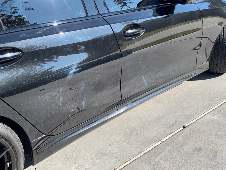

Took my vehicle in to have hood repainted at Auto Nation Bodyshop Spring, Tx through BMW Woodlands. They kept the car for 5 days.
Picked up vehicle Friday. My car came back looking like this. Moreover, hood repainting was done poorly - has light spots and swirl marks.
Also now- The entire car looks like it's been scrubbed with a Brillo pad ( car was/is ceramic coated).
1. Could this damage be in the ceramic coating or is it in the paint?
2. Is this repairable?
3. Any idea what that other marking on the side skirt is from?
4. Suggestions/advice?
I'm driving there first thing in the morning to show them and speak with them.

Get them to pay for you to bring it to a detailer. Cut and polish will have that back to normal. The big problem will be that they will need to cut through your ceramic coating and reapply after the correction. Keep that in mind when trying to get reimbursement.

I don't know. To me, the damage in those photos looks worse than the usual superficial swirl marks you get from an automatic car wash. An automatic car wash can leave superficial, circular swirl marks that are evenly distributed over most of the car.

It does appear worse and damage is not limited to just swirl marks. There's a huge area of the side skirt where the paint is now matted (first pic)

It's car wash. Happened to my Tanzanite blue at side skirts too. Apparently those side skirts take a beating in a car wash.

This is one of the downfalls of ceramic coating. Even-though you told your dealer that the car was ceramic coated, it doesn't look like the message got to the body shop.
If you buff a ceramic coated car without removing the ceramic coating properly 1st, paint would look just like yours.
You need to get the entire ceramic coat removed, get a full paint correction and have another coat of ceramic coat applied if you wish to go that route.
In my experience, body shops tend to do more damage than a dealer carwash as your entire car is exposed to overspray and paint particles while waiting its turn at the shop. To fix this, every car that comes out of a body shop gets a one stop buff and wax which usually causes more harm than good.
I would talk to a good detailer get the car repaired and have the dealership pay the bill....... do not take it back to the same place.

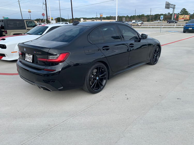

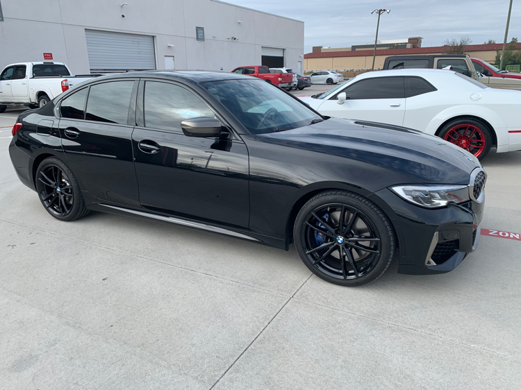

So the written description is their account of what was some. Also attached photos.
"We had your vehicle taken over to Xpel to have them inspect the swirl marks that were left on your vehicle after delivery. We addressed the overspray that was on the bumper, doors and rocker panel and had our wash department apply a booster for vehicles that have ceramic coating and had him hand wash and polish your vehicle to remove the swirls that were caused by the first wash after the vehicle was repaired. After inspecting the vehicle we could no longer see the swirls in the doors, the wash department did not apply any fillers or did any buffing the areas there was soap and polish involved and applied by hand. If you have any questions or have any concerns please do not hesitate to contact us directly."
