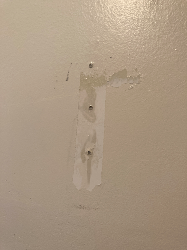

Need to paint match and seal holes in drywall
I had my bike mounted on here. After I was done I made two holes, and then i put tape over it cuz it looked ugly. I pulled the tape and the paint came off with it. My lease is almost up and I want to know is it possible to Paint Match this and plug the holes up so it looks like nothing ever happened? I just hope i get my security deposit back...... Thanks if you can reply and give me some tips!

Repairing the holes is easy. Use the handle of a screwdriver and push the sheetrock in at each hole just enough to make a bit of a hollow around the holes. Get a small tub (about 1/2 pint) of spackle from Home Depot or Lowes or any hardware or paint store. Spread the spackle over the holes as smooth as you can, don't worry about getting it perfect because you're going to sand it anyway and spackle sands very easy. You can get a small plastic putty knife for about $2 that'll work fine. Sand it with about 80 or 100 grit sandpaper after it dries ( a couple hours will be more than enough time).
The paint is going to be a little trickier. Most paint stores or HD or Lowes can match it if you have a sample. They usually want about one square inch minimum. Another possibility is to get ahold of the building manager and ask them if they have a little bit for touch-ups. If they're cool they'll give you enough to cover that small repair.

Wow Thanks! YEAH i called home depot they can paint match it. And i have enough pieces big enough. My landlord will never notice huh once i paint over it?

Paint the area, feather the new paint over the old paint for about a foot all around, not just dab wet paint on the repair area. Should be barely noticeable.

Get the spackle smooth and as long as the paint is the same sheen it should blend right in. Good luck

Did you put silicone on there? Looks like silicone in the holes.

LOL cringy but i put toothpaste cuz i dont like holes. I feel like its when transformers revenge of the fallen. The cube and the primes were in a tiny hole

You'll need to skim coat the area with some drywall mud. Then paint. But it looks like there is some texture to the wall. That'll be hard to match. Just ask your landlord how much it will cost. It may cost you nothing. Tenants can't be expected to not hang anything on the walls. You might just make things worse and piss off the landlord. Lol
