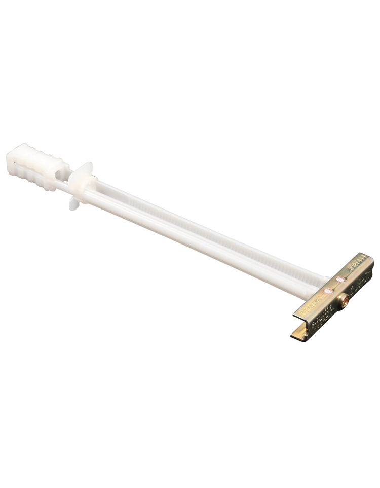

Butterfly/Toggle plugs, the big metal ones will hold 50lbs each use 4 then you don't have to worry about hitting a stud. I've done it many times. In fact I've used them to hang much heavier things than a TV.

You can either use a zinc screw type anchor or they make a kind of toggle bolt where you drill through the stud and when you pull the toggle out it flips sideways and grabs the back lip of the stud. The studs themselves are like paper when free but are shaped in a way that when they are screwed to the drywall taking away the ability to twist makes them operate like an i-beam of sorts, so they are strong. Most have an axial load of 300# + so as long as you do it right your TV isnt going to matter. Think about all of the cabinets and whatnot mounted to steel studs in commercial buildings. TVs on long armature mounts, medical equipment, etc.
You wont want to rely on the cheap $10 stud finders though, you really want to hit the middle of the stud. You can either get one of the nicer digital ones that use two sensors OR for almost no money get a little pack of the coin rare-earth magnets. Slide them up and down the wall until they stick to the fastener behind the drywall tape, then you can use a long rule to mark the stud in between the fasteners where you actually want the TV.
Here is a better alt to what murf posted, easier to get through a smaller hole and therefor through the stud itself.
https://www.amazon.com/TOGGLER-SNAPT...75289410&psc=1

I actually don't like to hit studs in commercial due to it being sheet metal, and given the thicker drywall requirement, I like to use these bolts below. In concert with stacked washers, there has never been anything that I have used these on that wasn't rock solid using just drywall. Use one each at the corner of your mount up to 65" and 1 foot off the wall and call it a day.
Either way, you're going to need an anchor, steel studs or not, and I would recommend these

No one has a fucking clue what gymprock is HF, it's drywall or confused dog turning it's head face.
The toggles there guys are talking about are odd looking, they come on long plastic rods, you push the metal toggle through, then pull the rods, snap them off and if done right these fuckers will hold a SHIT TON of weight. And I mean a shit ton.
But i hear ya, I don't like it either.
