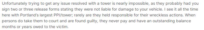

So , been watching this really great YT channel GTOger, about a car park behind a company that gets cars towed.
Made me think (so I am asking from a Canadian/Ont. perspective)
1> If your car is parked and for some reason, it is legally and correctly allowed to be towed, IF the truck tows an AWD by the wheels without a flatbed, can you sue them if they blow the transfer case, OR of shortly afterwards blows
2> How likely is that to happen, (towing incorrectly)
3> As there are a lot of AWD/4WD do they send flatbeds ?
4> Do truck drivers KNOW if the car is an AWD and take precautions or just say screw it
5> My back badges I deleted the XDRIVE badge, if I am de-badged (like a lot of folks I hear about) if it's incorrectly towed is there no way to sue, should I put an xdrive/AWD badge on to be safe, would it even matter ?
So far I have just got tickets (not for a long time) and I don't envisage a tow, I was clamped twice , but never towed
Your thoughts please

Tow trucks seem to always cause damage unless the owner is hiring the tow (and even then,…). I have never heard of anyone getting damages from them; just an impound fee to pay. I would guess there is a release for damage in the vehicle release form when the impound fee is paid. Best to not get towed for involuntary reasons.

mistakes happen, what I'm asking is about towing AWD's, (if there is an AWD sticker on the car) do they know or care and is there any recourse, and what likely damage
IF your going to debate whether to park "correctly" or legally or something other thing... (which is TOTALLY VALID AND I AGREE WITH) is NOT the point of this thread.

I did do some googling though

Towing AWD (not 4x4), not flat towing (all 4 tires on the ground and moving) will cause damage. Maybe not immediate and noticeable. But it will surely take life off the internals in the AWD controlling unit; be that a unit tied to the transmission of the front/rear differential. The vast majority of modern AWD's use a clutch based system. That system relies on fluid pressure to engage and vary that clutch making sure the front and rear wheels are rotating at equal speeds. When you do not have power to the 'tcase' and the front or rear wheels are not turning the clutches will eat themselves. Travel far enough and the friction material is gone, leaving only the steel backing. That backing will fuse, lock the input/output shafts and lockup. Destroying the bearing/case.
You can not tow AWD with 2 wheels immobile and not cause some reduction of life or damage.
The exception is if they pull the driveshaft ... no one will ever do that.
4x4 you can put the tcase in neutral and tow with the front wheel up. No damage.
Far as accountability, that will vary by tow company and local regulations. A lawyer is the answer to that time/question.
