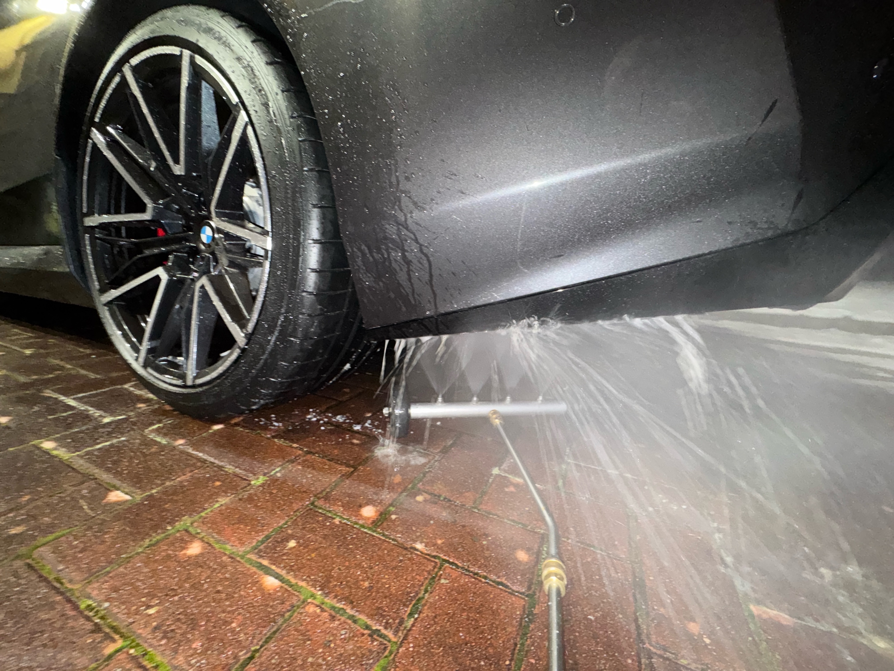

Anyone who does a bit of engine-powered boating on salt water is likely familiar with the salt antidote, ‘Salt Away’.
It’s a flushing & rinsing detergent that defeats existing salt & leaves a salt-resistant film on all manner of objects.
I have used it on jetskis and trailers and have found it excellent. It’s biodegradeable and made of all sorts of lovely stuff according to the manufacturer.
I was thinking it would be ideal for wintry-conditions when roads are being salted resulting in underbody corrosion.
My plan is to use an underbody lance to rinse the car with a Salt Away solution, see images.
I wonder has anyone thought about doing this or whether someone already is and whether it’d be unkind to the complex undercarriage of G9x?

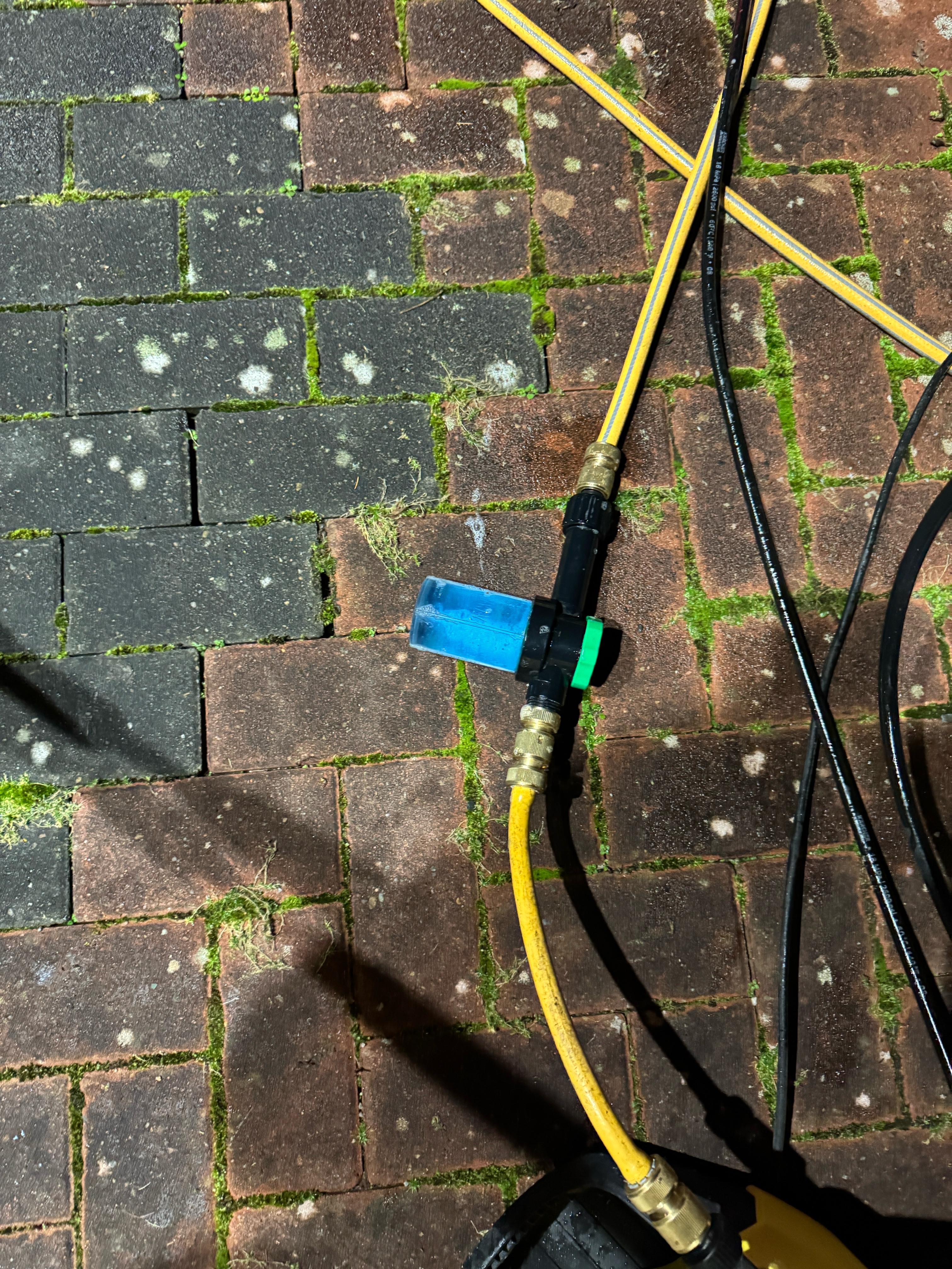

Yes, I think car heads have been missing a trick with this and the boaters have kept the benefits to themselves.
It appears to be pretty much everywhere.
Good stores that sell boating equipment likely stock it. We call call those stores ‘Chandlery’ shops but Amazon is certainly an option.
Advise you stick to the ‘Salt Away’ brand. There are a few copy cats that may be amazing but I have no experience of them.
Be sure to buy the ‘kit’ initially… it comes with the doser you’ll need to attach to your garden hose (it won’t handle the jet washer pressures directly).
My plan is to feed my jetwasher via the garden hose with the Salt Away doser inline the feed side. Then hit the undercarriage using the special lance.
Simple enough setup that should deliver a corrosion-free car for the long run.

I treated mine this evening. Took about 30mins to sort the hoses to put Salt Away through the pressure washer but easy to repeat now.
Can’t hurt.
