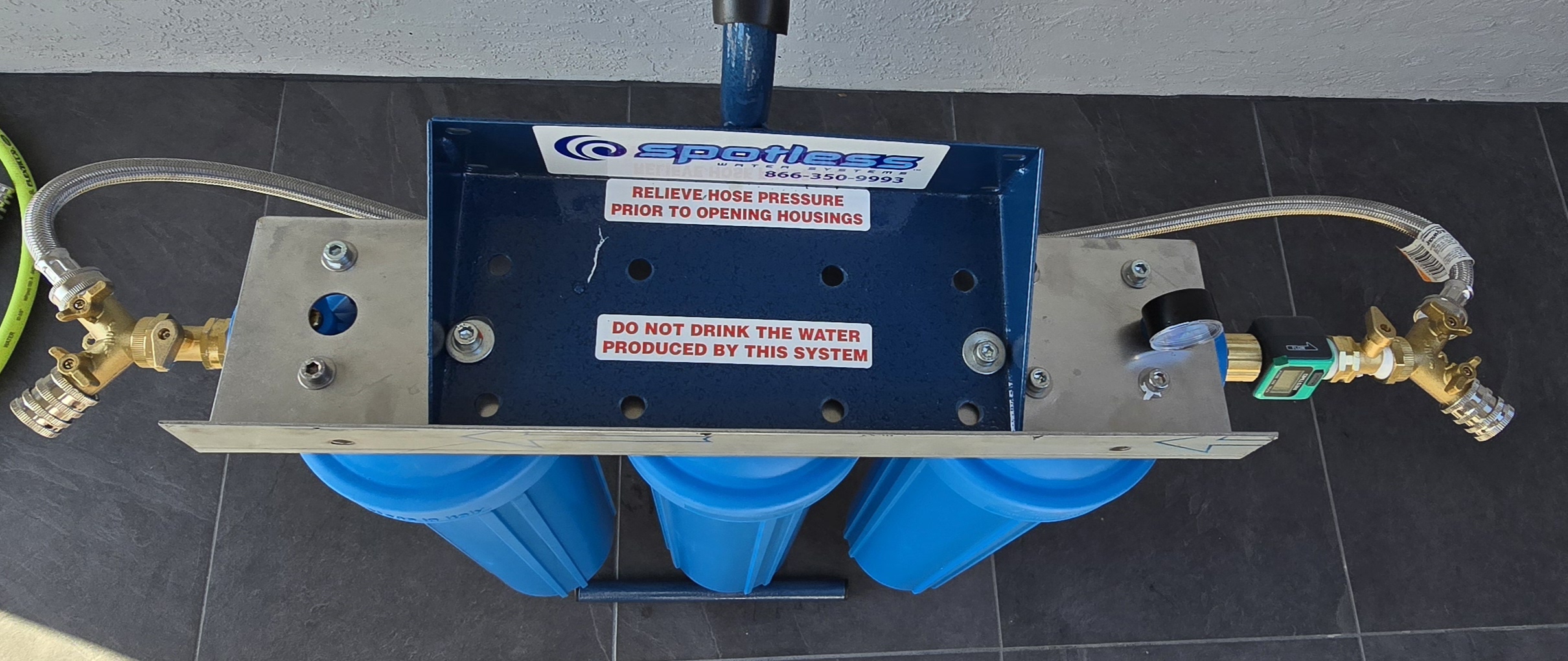

I built my own 3 stages DI water system! For some reasons, our water has low TDS (around 50) but has some discoloration so I do Sendiment-Carbon-DI. I retrofit the CR Spotless cart since I use the system to clean the House Windows and Solar Panels couple times a year.

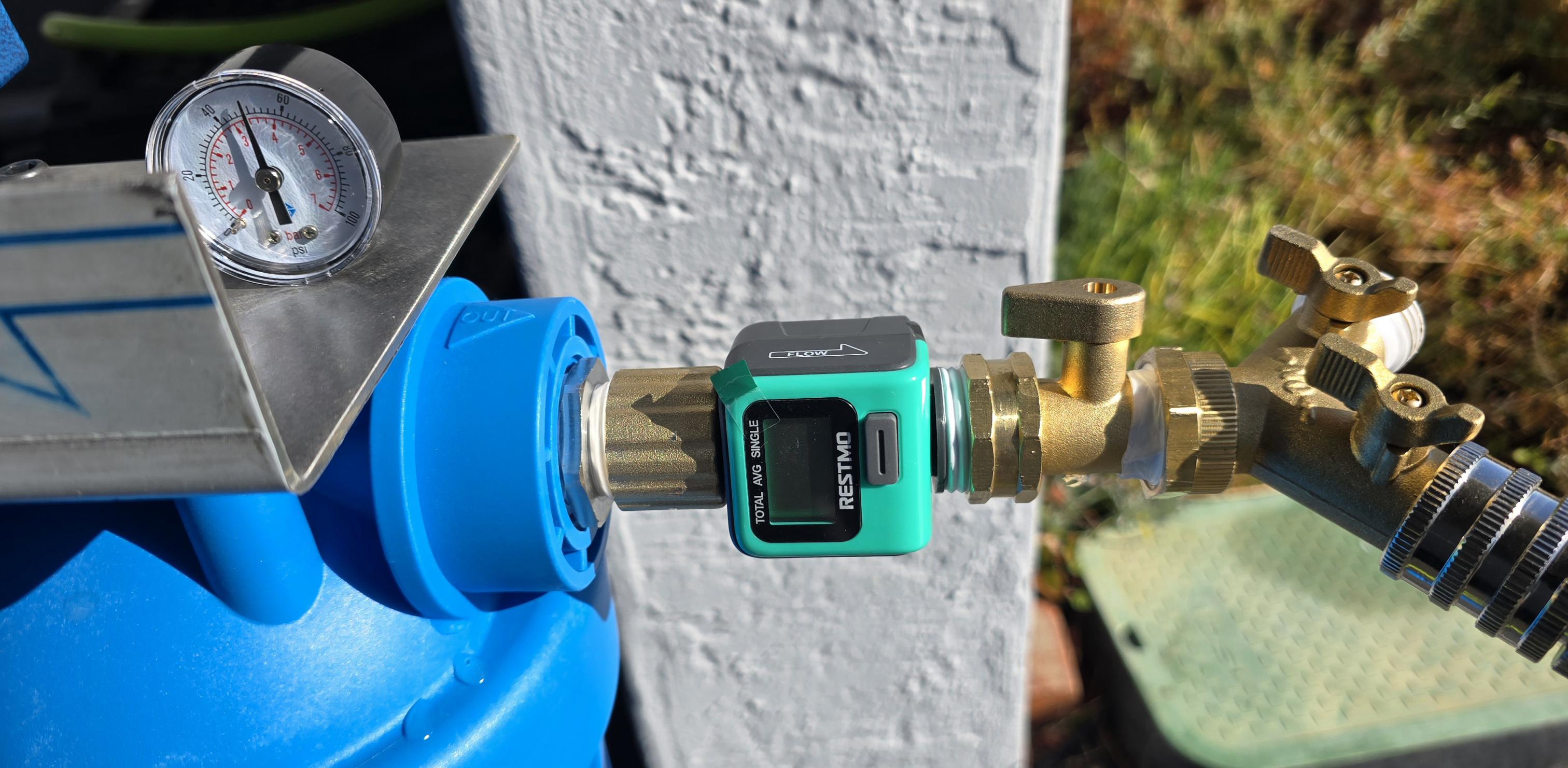

I just use the Shutoff valves and T for bypass. The stainless steel hose appeared not to affect the flow! Also add a flow metter to monitor flow and total consumption.
I spent less than half the price of the CR Spotless.

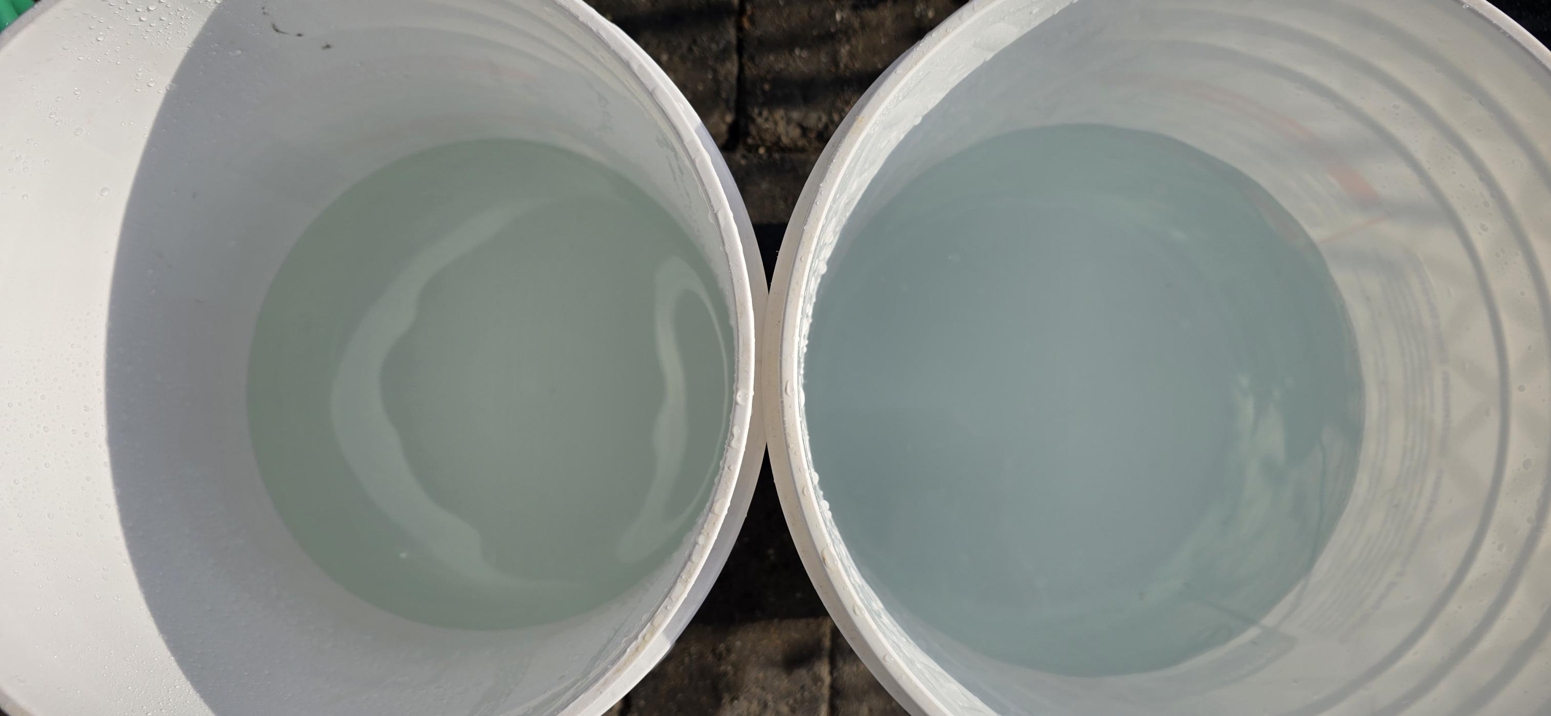

You could tell the water before and after
One of the best things I purchased. Now I could wash the car anytime and don't have wait for the sun to go down and dont even blow/wipe the cars after unless I apply sacrificial detailer afterwards.

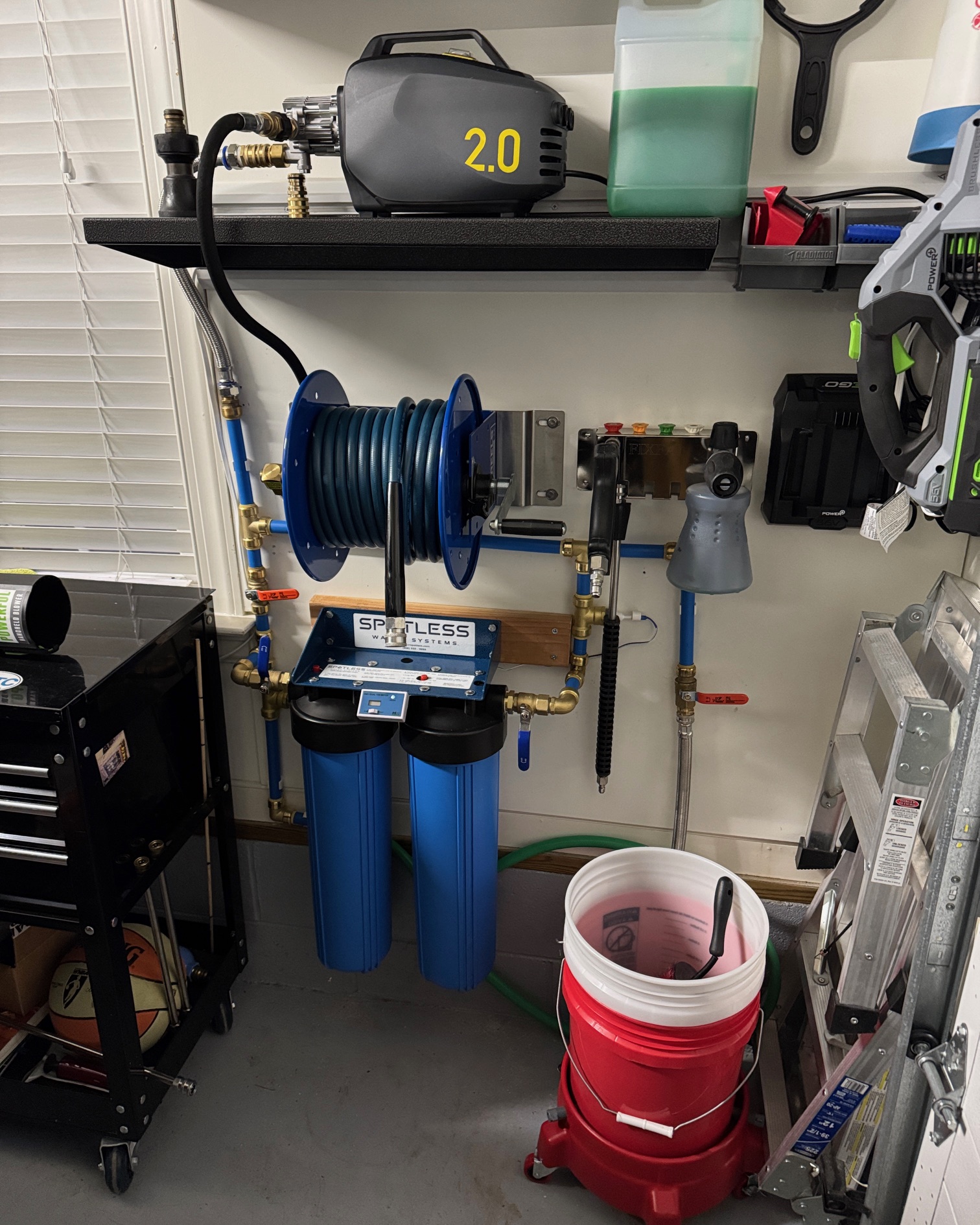

Here's my homemade pressure washing station. Although the DI system looks like it came from CR Spotless, only the mounting bracket is from them (it was more substantial than any other ones I could find online). Everything else, other than the 3/4" PEX pipe (which I got at HD), was sourced from either Amazon or Ebay. Additionally, instead of using DI cartridges, I am using an adapter kit that allows me to pour a 1/4 cu ft of resin into each filter for more capacity. Currently, I have it set up with a quick connect to attach it to my garden hose but will be connecting it directly to my house water supply as my next project. I also have quick connections on my Active power washer and an additional HP hose so I can disconnect it and use it for other duties around the house.

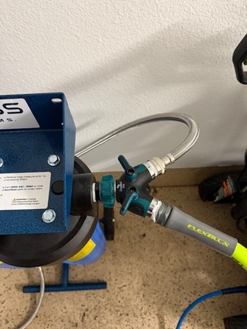

I've put together my CR spotless bypass. Some of the systems I saw online directly had the Y connect on the output, and they say you actually never have to touch those valves/controls.
In my head I think this mixes the tap with the DI water, but I'm guessing there is some chemistry/physics that avoid this? Or does it mix a bit but it clears quickly once you start using the DI water and turn-off the bypass (on input)?

That is not how I would do it.
What you're doing here is trying to shove water into the DI system. Presumably, you have a similar y on the other end so there's nowhere for it to go directly out, so it's just all mixing around inside. So you're using up resin and not getting anything out of it of benefit.
If you added a shutoff valve between the Y and the DI system, it would work, you would never close the house side of the y, and close the shutoff at the Din and open the bypass portion of the Y to bypass it. I would duplicate the setup on the output side to
Just my take, I'm no plumber or hydraulic engineer.

Yeah, I thought the exact same thing as you blkGS. But even when I look at CR Spotless' own bypass system (link below) this is how it's set up. The outlet bypass only has the Y connector. Maybe there is something I'm missing, but I just think when the tap is active it somehow mixes when pushing through the output Y which has to be fully open.

I tested the CR Spotless (dual Cartridge model) and the flow was around 5.1 GPM. My special setup of 3 Cartridges yields about 4.1 GPM. The Active 2.0 requires about 1.8-1.9 GPM so plenty of flow.
