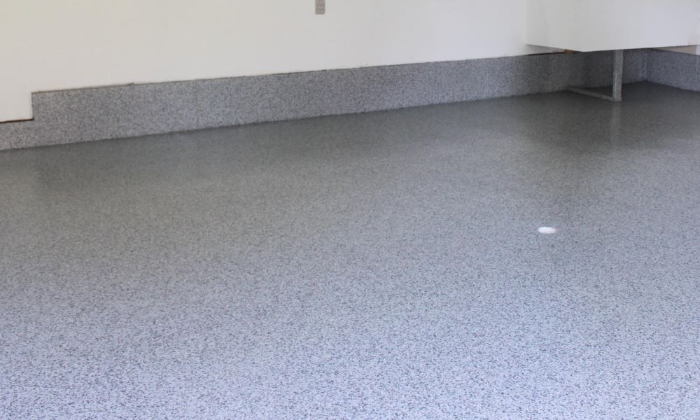

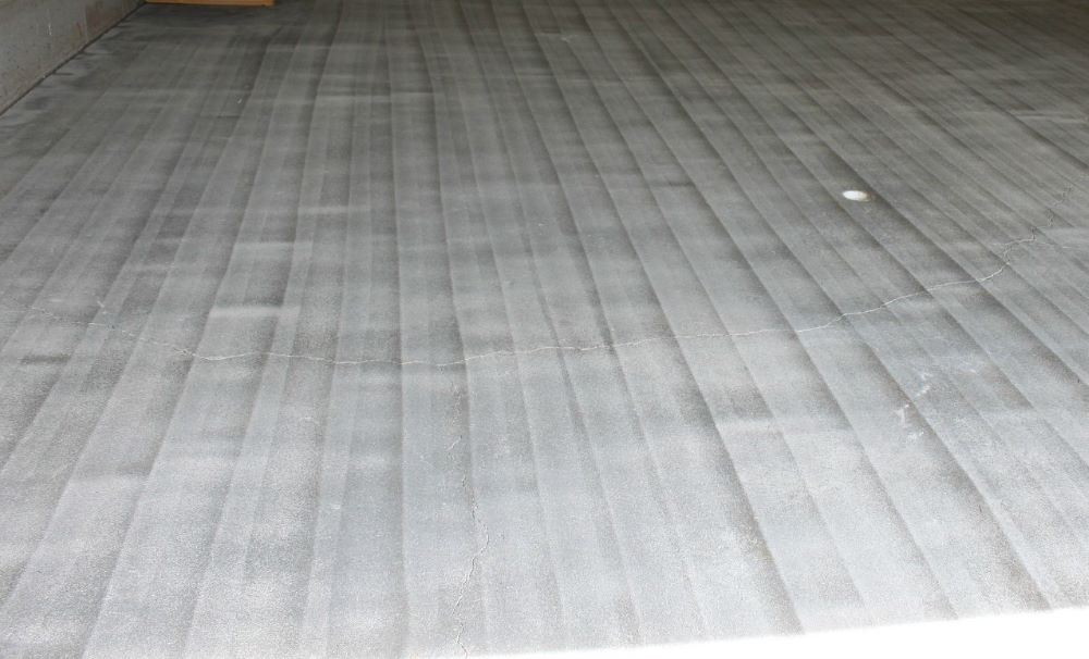

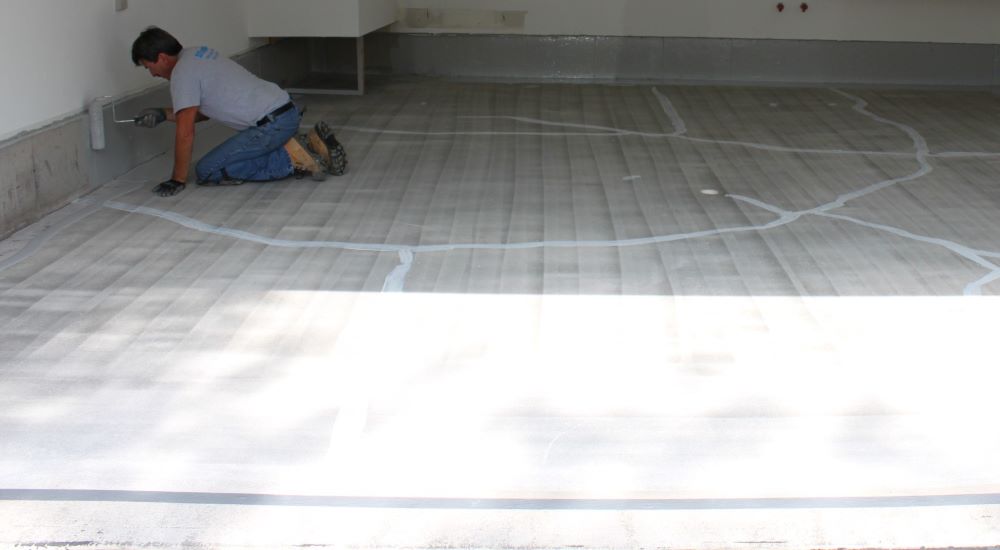

      03-13-2025, 01:27 PM   #4
Originally Posted by S1nner View Post
I had my garage floor coated a few years ago.
You got fleeced. Your floor looks like it was improperly prepared to receive the epoxy, flakes and topcoat.
Did they sand and etched the floor, expose the cracks if any and seal them...?
Did they allow at least 24 hours for the epoxy and flakes to settle before the UV protectant clear topcoat...?
My floor has gone through ten winters and still looks brand new.
