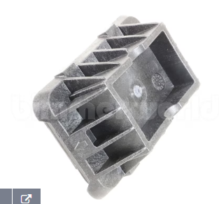

I'll try to explain the use of plastic lifting points on BMWs (and other German market cars) so we all can better understand. "Adapters" are a result of the internet and misunderstanding of how to lift a modern BMW. Being that I have a 2-post auto lift (and reading the operating instructions for it), I have a better understanding of why the plastic lifting points are designed as they are. I've left several of my BMWs on my lift for weeks at a time without and damage to the plastic lifting points. Professional auto shops don't use "adapters" because they use professional lifting tools to lift your BMW when they work on it, especially a BMW dealership since BMW engineers design BMWs to be serviced at BMW dealerships.
Pictured is the lifting pad for the G20 (the latest P/N for a 2025 BMW I could find), but it is typical of the design BMW uses for most of its models dating back 20 years. The E46 uses a similar "walled" design. If you want to find the lifting point for your BMW, use RealOEM.com and you'll find the P/N under "Vehicle Trim - Various Body Parts - Sealing cap/plug". All lifting points start with "5171".
The lifting point is designed for a professional car lift with foot pads that sit under the lifting point to raise the car level at all four points. Damage to the plastic occurs when DIY'ers improperly use the lifting point with either a floor jack or with the incorrect jackstand head type. ESCO stands are the best example of the proper "flat-top" jackstand to use for supporting a BMW. Most people don't understand how a floor jack is supposed to work. If they use a floor jack to lift from the side, the jack is supposed to roll under the chassis as the vehicle is lifted because the arm of the jack swings in an arc from its pivot point on the jack. Most shitty cheap floor jacks DIY'ers use don't roll well on concrete let alone rougher surfaces like asphalt or dirt/gravel. If the jack doesn't roll under the BMW, the cup of the jack pulls on the lifting point walls and tears the plastic up. The plastic gets damaged because the walls are not designed to take force (pressure) in a lateral direction. Similarly, the walls will get damaged if a DIY'er uses a typical "axle-type" jackstand designed to support a vehicle from a live axle (like pickup trucks use). The weight of the vehicle is placed on a very small section of the wall, which exceeds the design capacity of the wall and breaks it. The lifting point is designed to spread the weight along the entire perimeter of the wall, which is why a flat-top stand (or lifting foot pad of a professional car lift) are best suited to support the vehicle.
Comments on the typical BMW lifting point design: The lifting point has walls with a cavity so road debris or curbs that may hit the lifting point will break the wall or the lifting point entirely off the chassis rather than damage the rocker panel or frame member the lifting point where the lifting point attaches. In other words, the lifting points are consumable parts designed to prevent damage to the vehicle body in case they contact an object. So, when a DIY'er uses the improper lifting tools/technique to raise or support his BMW the plastic lifting point gets damaged because it is designed to get damaged; it's not a design flaw or weakness of the part, it is protecting the chassis from further damage. The little arch in the middle of the wall is required by SAE (Society of Automotive Engineers), because it shows the technician where to lift the chassis. All cars have these notches (called "chevrons") on the chassis/frame as a safety feature to prevent improper lifting of the vehicle by the mechanic.
The internet invented "adapters" because people use the wrong lifting tools or techniques to lift their BMW.
