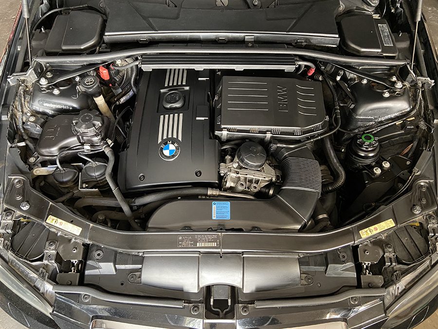

Damn, your engine areas look brand new! Amazing. I don't understand how my engine got so dirty, I honestly don't open my hood all that much, but it still became so dirty.
I'm just concerned that if i blast my engine bay with degreasers, cleaning liquids, foams it would cause some damage to some electrical wiring somewhere? or cause some nuts or bolts to rust? and/or otherwise get liquid into crevices or areas that should not get wet? everything is so densely packed too, i don't think i can clean everywhere since there are many tight areas my hands/arms won't be able to get into or reach. One good thing is my car battery is actually located in the trunk, so I don't have to worry about getting the battery wet. I'm thinking to be safe I should disconnect the negative terminal before I blast my engine with liquids just in case.
