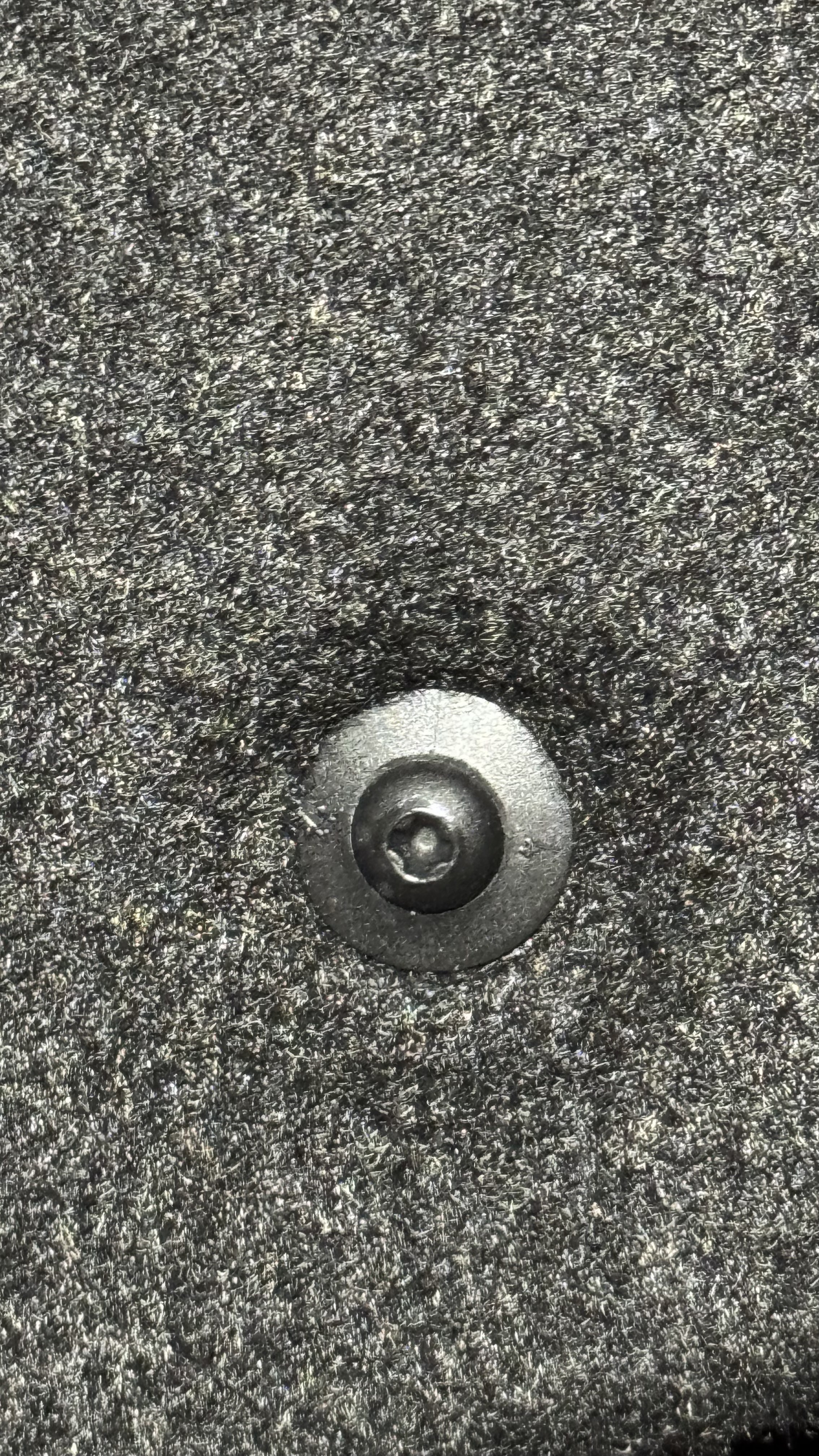

So far the only thing I’ve attempted to do is remove the dashboard in order to install the Bimmerplug apple carplay retrofit box, and that was a huge pain in the aśś because I don’t have any torx sockets, only a torx key set, and it seems like every nut bolt and screw on this car has a torx head.
Specifically the thing that made me make this post, are some stupid fasteners holding the trunk lid liner in place. The gasket around the rearview camera is completely eaten away and id like to replace it, but I am unable to remove the fasteners that hold the trunk lid liner in place. They appear to be a sort of Philips head, but none of my Torx or Philips heads are able to unscrew these fasteners. I’ve attached some pictures of the fasteners below.

Shortly after making this post, I was able to find a Philips head in my computer / electronics toolkit that seemingly fits the head of these fasteners; but it’s still not a very “secure” fit and I’m worried about stripping the heads of the fasteners.

Generically speaking there are a lot of places that use torx / etorx.
You may want something like this for example:https://www.amazon.com/TEKTON-Extern...35&sr=8-8&th=1

In addition to torx, I also needed etorx (or external torx). I believe the strut tower braces use them, if I remember correctly. Depends on the model, of course. A good set of plastic pry tools are also helpful.

I believe that is a wide cross fastener, might try a square bit if you cannot find a wide cross

Torx and E-Torx set is the biggest differentiator specifically for BMW. Allen sockets up to 14mm in size are also useful for some plugs (diff, transmission, etc.). Make sure your regular socket set (and wrench set) doesn't skip sizes (in shallow and deep sockets), you'll find everything from 6mm to 19mm somewhere on the car. Ratchets, extensions, universal joints, etc. are not any more unique than most car brands and depend on the specific task at hand and how much of the car you can take apart to gain access (meaning get more as the need arises based on DIY guides). Powered socket driver (either gun style or air ratchet style) will speed up undertray removal and reassembly (these are held on with a large number of fasteners).
For the specific fasteners, I would try to pry them with a trim tool (plastic and metal), the cross head might be a red herring.

Clip
So, RealOEM shows a part# 51488252749 Clip in the trunk of a Six Series. Looks like the correct form but, alas, the wrong color. In any event, that clip may need to be pried out rather than screwed out. It might help to access RealOEM with your VIN to retrieve the actual part number. On second thought, this part actually looks like it has a different indent than your part. Sorry.
