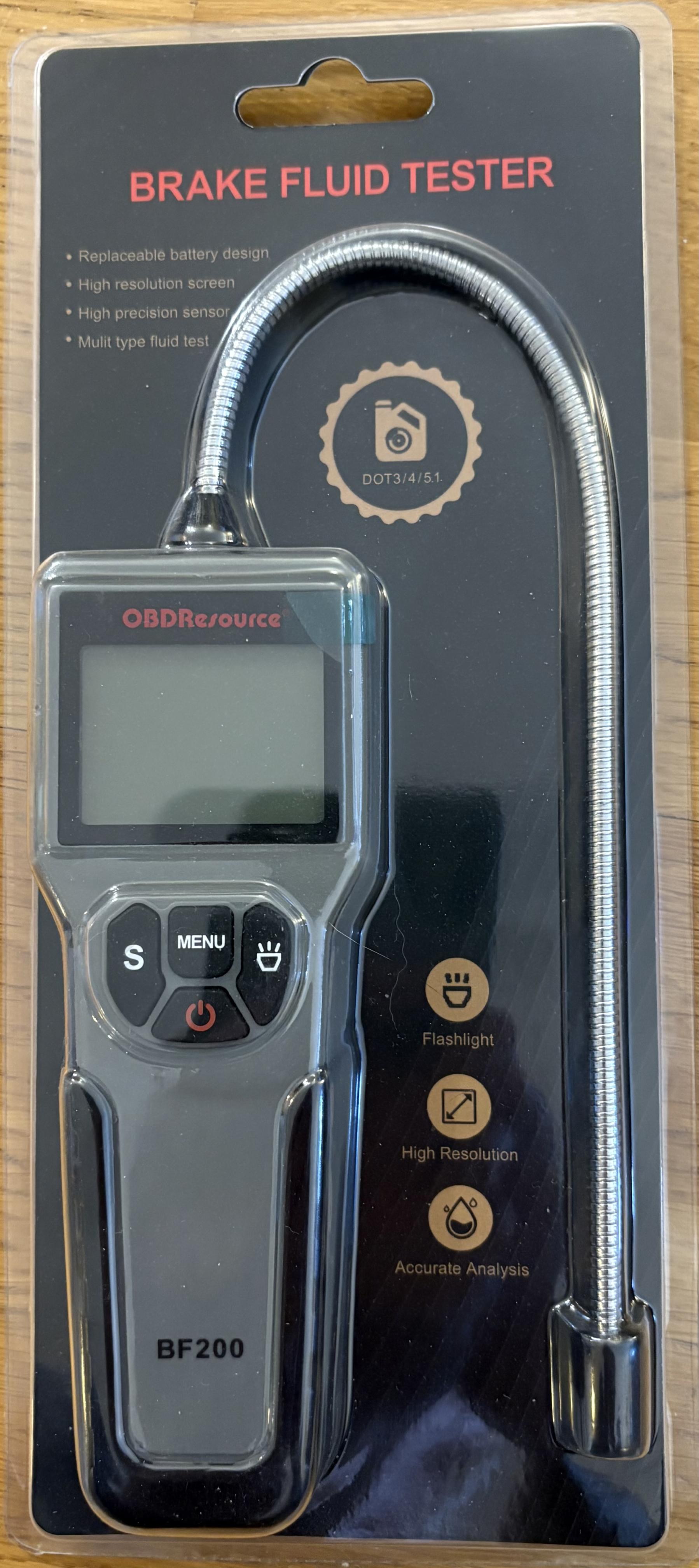

Brake fluid is hygroscopic, and naturally absorbs moisture over time through brake lines and brake reservoir breather hole. That presents two problems:
1). Water in your brake lines tends to settle at the lowest points, and those are calipers and ABS pump. Over time, those start rusting. In case of calipers, they start sticking and will need a rebuild. In case of ABS pump, you will be buying a new one.
2). If you brake hard enough to raise brake fluid temperature level about 100F (calipers heat first, where water is collecting!), water will boil and turn to vapor, which is highly compressible. Then your brake pedal hits the floor without slowing the car down, your pants turn brown, and you revert to impact braking.
I recently got a moisture tester. If the moisture content is low the interval can be extended.
Not exactly.
All brake fluids have a Dry boiling point (BP) and a Wet boiling point (3.7% water contamination) disclosed by the fluid manufacturer. The speed of degradation is very dependent on what fluid you start with, and your ambient humidity.
If you start with a high-quality DOT 4 fluid like Motul RBF600, your Dry BP = 617F and wet BP = 400F.
If you start with cheap-o DOT 3 brake fluid, your Dry BP = 400F and wet BP = 284F.
So even with prolonged service and water contamination, high-end fluid will outperform cheap fluid in terms of resistance to brake fade.
However, the rusting from water contamination will be a problem with both fluids.
How much rust do you want in your calipers? In the ABS pump?
What fluid did you start with?
In the end, it all depends on how much you care about your stopping distances & safety vs. saving a few bucks on maintenance.
