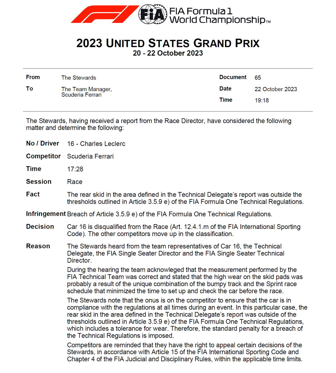

As we know by now, the Technical Delegate only scrutineered the planks of the cars raced by the podium finishers and the pole sitter: two cars complied (minimum 9mm) and two didn't (<9mm). No time to scrutineer all technical aspects of all cars after races. Samples.
Ferrari and Mercedes do not dispute the DSQ decisions and no team requested additional scrutineering of other cars (for example the cars of Sainz and Russell) (even if the regulations would allow any such request - probably not - then still it could not be granted once the cars have been released to the teams).
Toto Wolff: "Turning to the race result and the disqualification, set-up choices on a sprint weekend are always a challenge with just one hour of free practice - and even more so at a bumpy circuit like COTA and running a new package. In the end, all of that doesn't matter; others got it right where we got it wrong and there's no wiggle room in the rules. We need to take it on the chin, do the learning, and come back stronger next weekend."
So officially P3 and P5 instead of P3* and P5* for Sainz and Russell for this race.
Maybe a journalist could query Vasseur and Wolff whether the plank set-up of their other cars (Sainz and Russell) was identical to the one that ended with DSQs for Leclerc and Hamilton. As they will almost certainly reply that the set-up was different (either because it's the truth or for convenience reasons to avoid a second DSQ), they could be asked to explain the reasons for the (deliberate) difference. Each driver has his personal preferences and driving style, of course. They could also reply that they don't want to revert to that issue anymore, turned the page and now look forward to the next race.
Anyways, it's a warning for all teams and drivers: comply with technical regulations or risk DSQ.

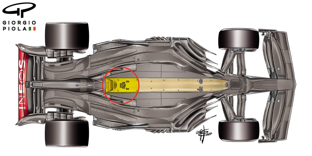

That's correct. Scrutineering report: see here (PDF - 4 pages: see pages 3 above and 4 below).

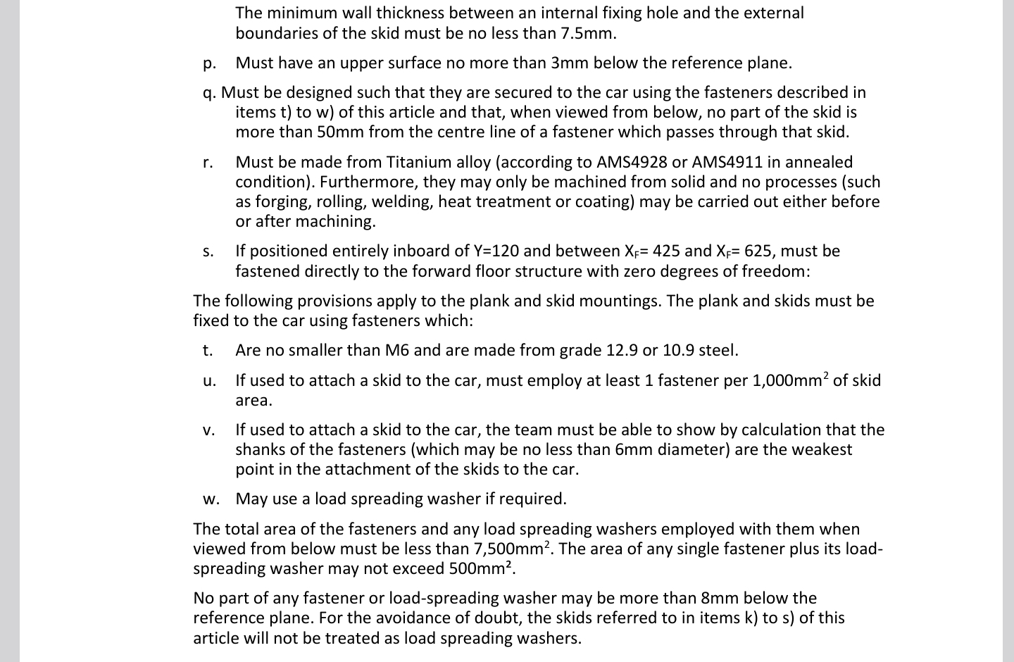

Article 3.5.9. e) of the 2023 Formula 1 Technical Regulations:
