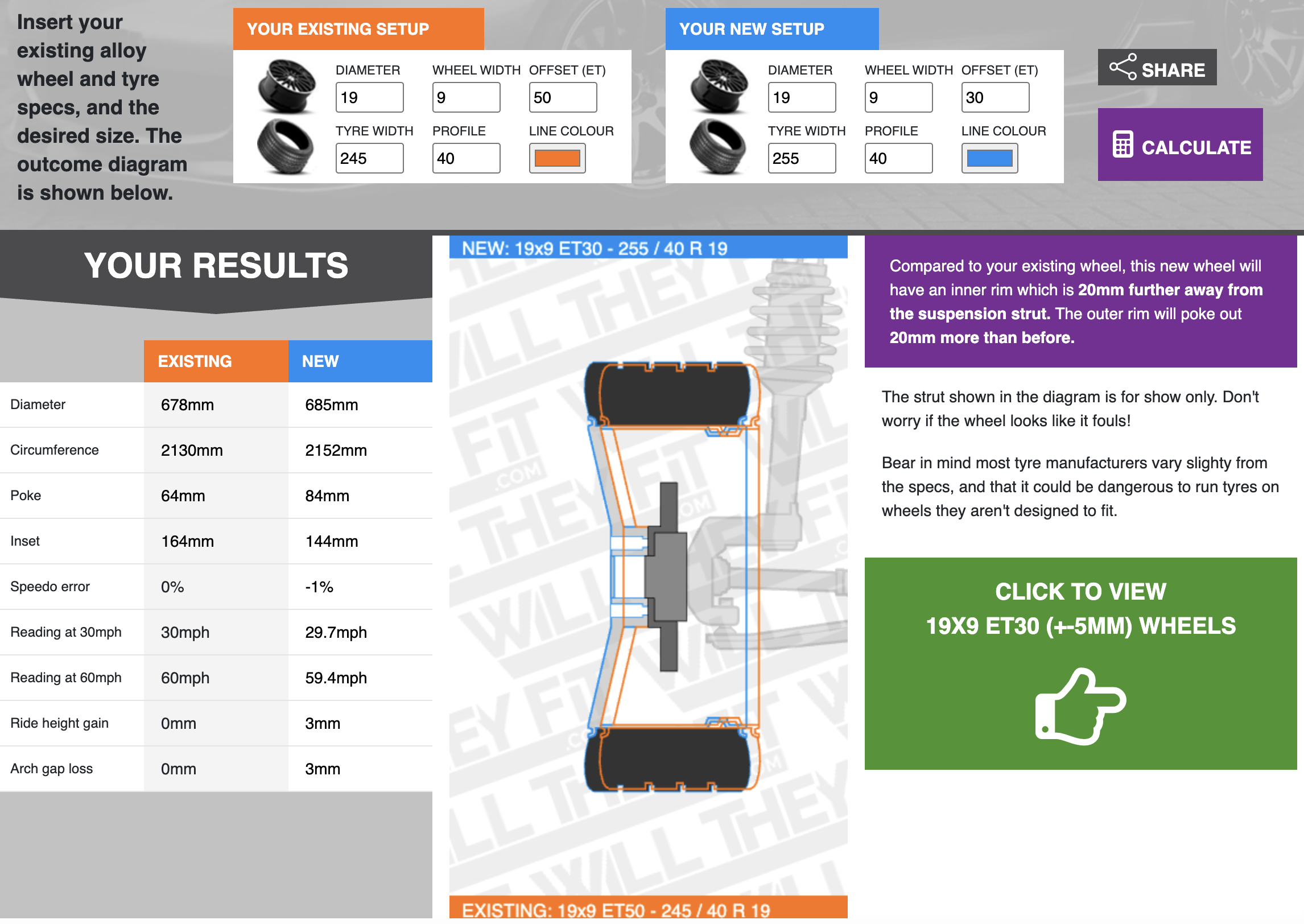

There is a 1% size difference between the two tires. This will set off the x-drive.
https://www.willtheyfit.com/
2019 X3 M40 | 2016 Golf R | 2004 M3

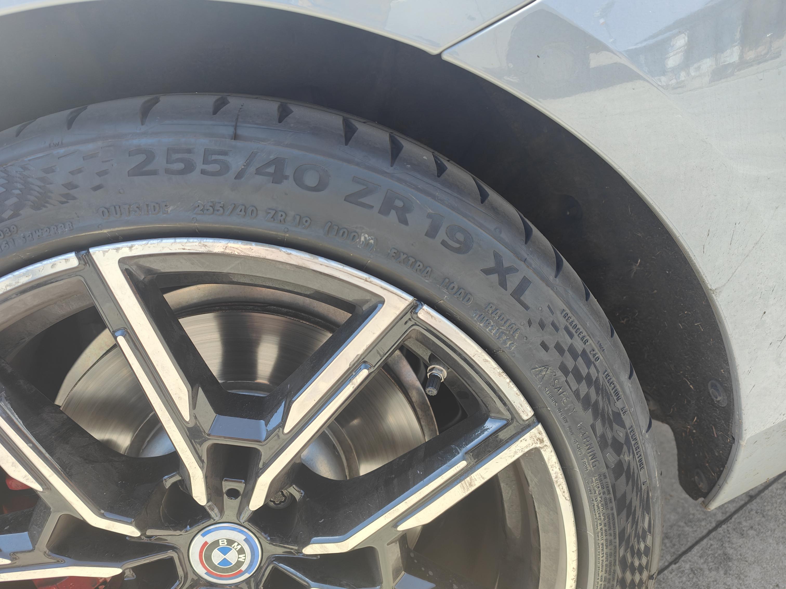

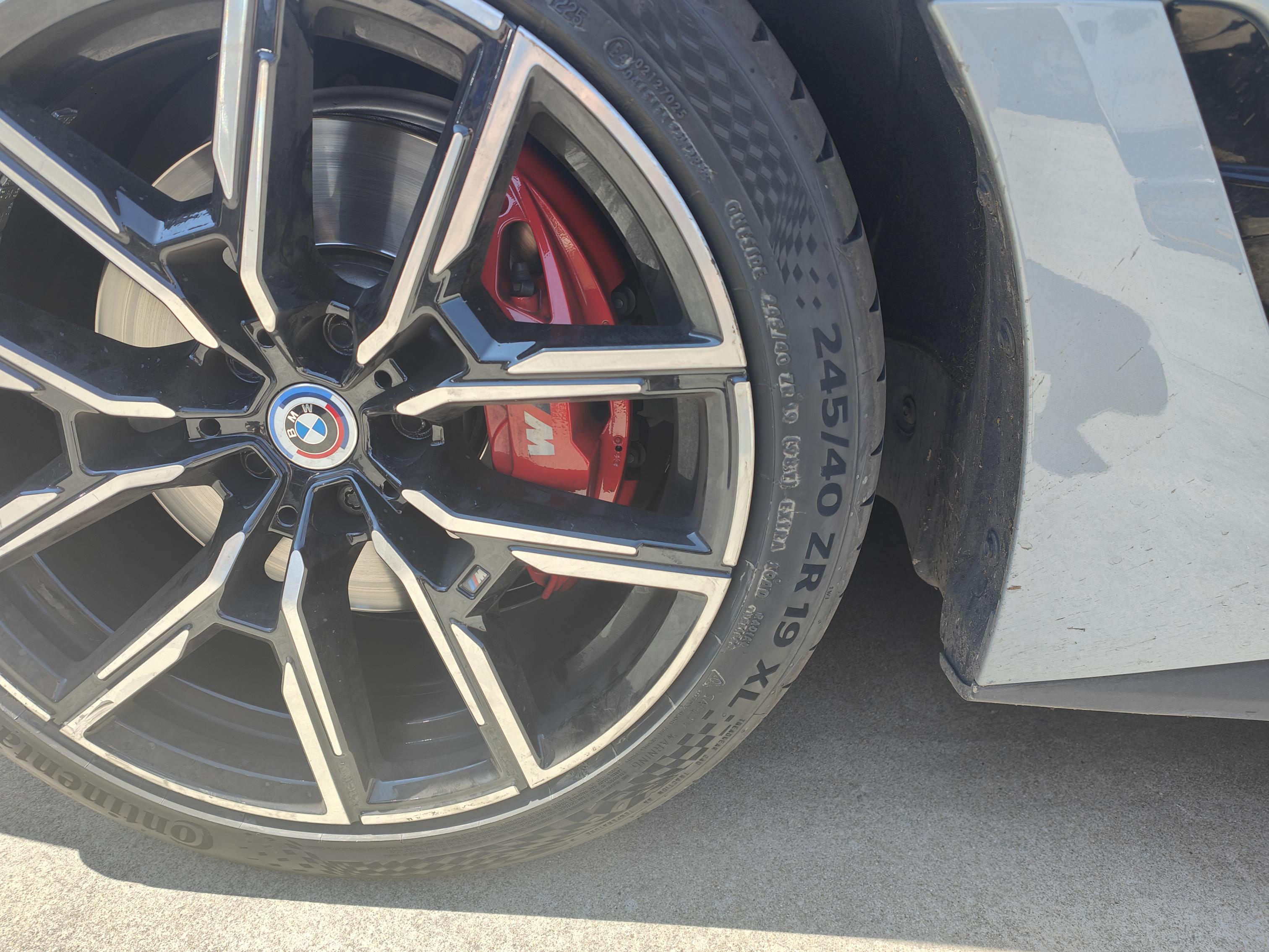

In seriousness what I suspect is that the 245 conti is unusually small and the 255 is unusually large. This is generating more than 1% difference between axles since the sidewall ratio is identical. There are strange differences in sizes seen sometimes. It's not just continental. It seems these measurements are more of a reference point than truth in dimensions. Always best to try to match the circumferences 100% in electrically governed AWD systems.
I also heard that after 180kmh the front axle will totally disconnect and you only drive in rwd
Since I also tried already a 50% acceleration from 200kmh and this issue also appears I think there is just some issue with the rear tires
Unless im wrong about the front being disabled after 180kmh
Oh I also forgot to say if I partially turn off DSC or fully off the car has no issues
